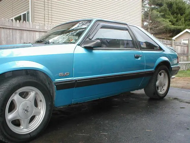

I did the clay bar thing today and I must say I can not tell the difference. I did it with the Mothers detailer stuff followed by the supplied wax. Doesn't even bead now... Sad to say I am not impressed. Was I expecting too much, or is it just the color of my car will not provide the luster I seek?

claybar is used to remove any oxydation/particles that are stuck/baked onto your car that simply washing/waxing does not remove.
also when you claybar it removes your wax and whatever else is on the surface of your paint and thats why water is no longer beading up.
since youve already used the claybar next step i would do is put some polish on there to get the deep shine and after that seal it up with some wax and that should do the trick :nice:
uhh dude the claybar really wont make the car shine all that much more, its purpose is to prep the surface and remove all the contaminants so you can apply your waxes and stuff. also when using claybar make sure not to drop it if you do throw it away. the cleaner wax they supply with it really isnt good for anything. plus being a fox you have single stage paint which makes a really good shine hard to do without a buffer and some quality products. try this site out and sign up, best thing you will ever do:

I'm a little stupid today. Sorry I posted this in the wrong sub-forum.... Not single stage. Base/clear. I understang the whole it cleans thing but I should have more descriptive. The paint is now smooth yes but it still looks dirty as heck.. Just tried it on my wifes van and it worked amazxing so it is just my paint.
