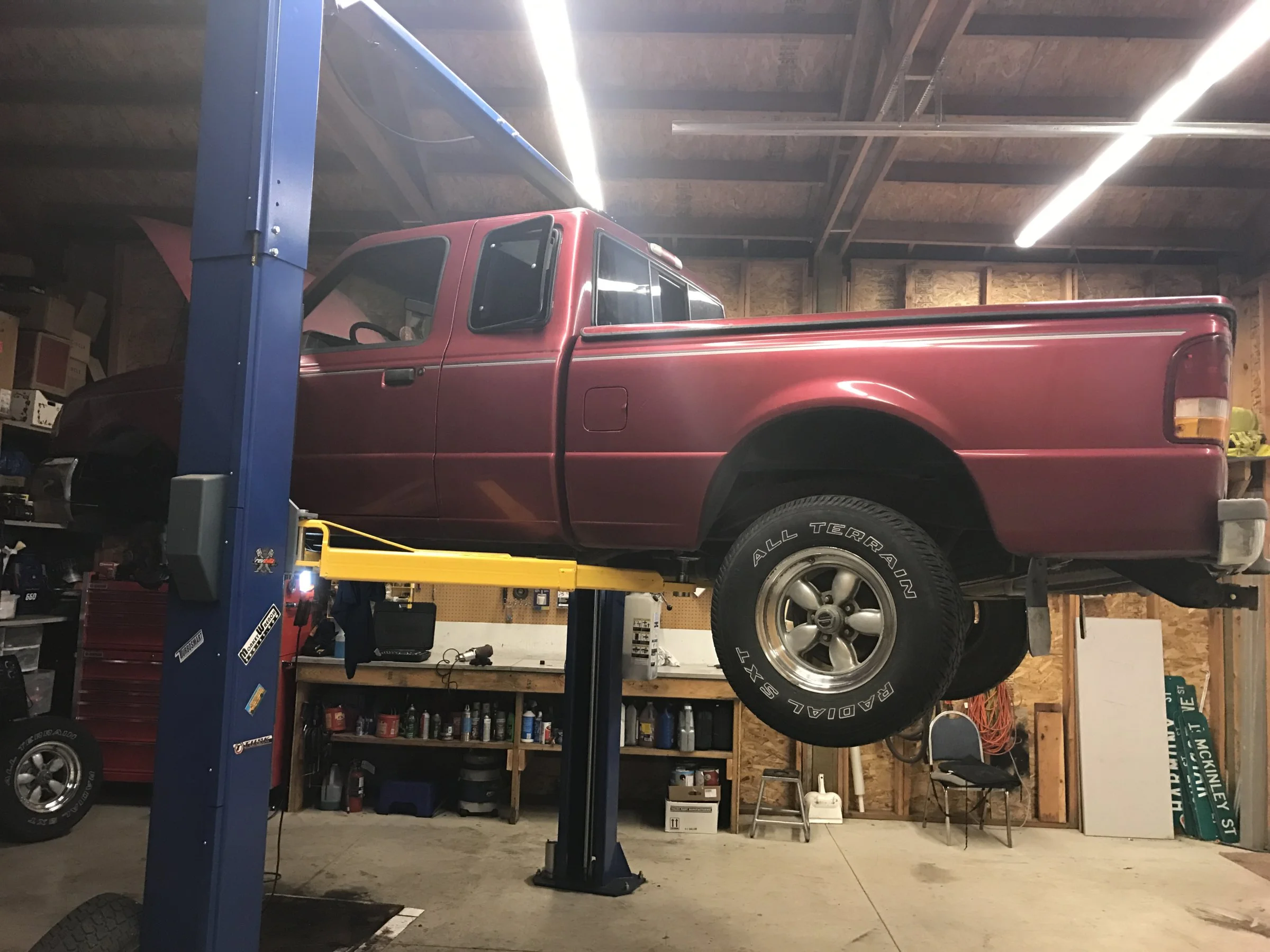

I did recently buy a ranger off a co-worker for $400. The 5 speed was trashed so I had it rebuilt. I am actually installing it today. 2wd 94 4.0 extended cab.
To be clear this is a make it run project, no mods! I can use a decent cheap little pick up.
