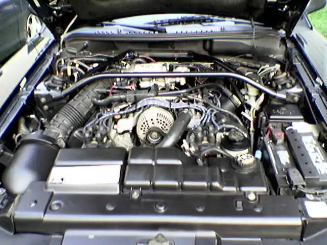

i was asking if you had the coil on plug design with the new heads like the 99+ do. i guess the 96-98 had coil packs? do you have a pic of your engine bay? anyway, good goin with the new plugs. couldnt hurt anyway
