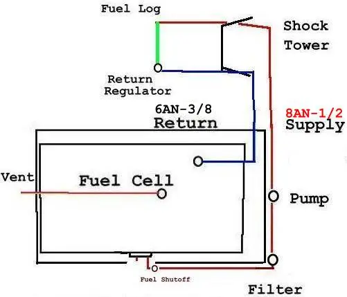

Here is how mine is set up with a Holley Black:
Full fuel system:
http://www.qsl.net/wd4ngb/birdwork5.htm
