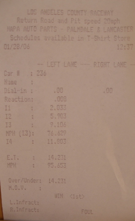

I have 4.10's and an auto.
I Run 315X35X17 BFG's at the track. Lock out OD and you will still have plenty left when you cross the line.

At the track
