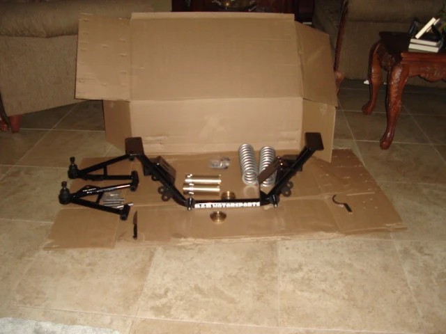

I got the Tubular D&D Motorsports K-member, Tubular A-arms, and coil overs... Mine was simple to install, and as far as i can tell it retained the stock location. Im not sure how it compares to MM cuz this is the only K-member i seen in person, but it look pretty nice IMO.
-AJ

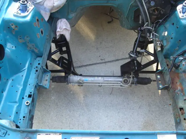

Just so happens that I got my new k-member this week from PA racing. It looks great. Quality is great. It does keep all the stock wheel base location. And is suppose to offer the most header room out of all the aftermarket k-members.
It cost me $330 with out spring perches because I run coil over. The perches would be another $40 or something.
And it fit like a glove!
Here are some pics:

Here is a pic from the passenger wheel well:

Yours looks almost identical to my D&D k-member...
-aJ
