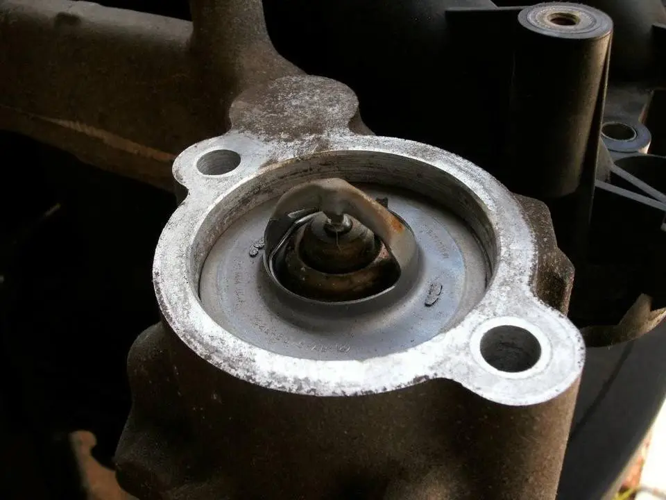

Twisted Intake Gasket!
SFC.Kill said:
I found a intake manifold bolt loose. I missed it torqueing down the intake somehow. I torqued them all to 22 ft lbs. I found a small leak in back of the thermostat housing. I twisted the gasket putting it on. The spring end of the thermostat goes down in the intake manifold and the bridged top goes in the thermostat housing correct?
Yes, the spring faces downward like in the picture below. Then the O ring (not shown in the picture) sits on top of the thermostat, not below it. The intake in the picture is the one that we replaced. It was leaking coolant in two locations, under the thermostat housing base, and on the opposite side under where the aluminum cross over channel bolts to the intake manifold. We replaced that intake, with the one with the integrated O rings, no flat gaskets. We used a 180 degree thermostat. We torqued the intake bolts to 18 ft lbs. So far, no more coolant leaks, or overheated problems. Are you saying that you have to replace the twisted intake gasket? Hope this helps. Good luck, Tommy.
