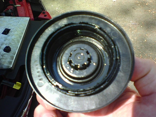

There is a rubber gasket on the inside of the cap.

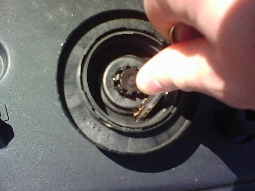

That was a buddy's '05 yesterday. Let me go check my '06 right now.

Yes, there is clearly a rubber gasket in my cap as well. Pressing on it with a key leaves a small indentation then it goes back to its original shape. Also, on both of our caps, you could hear the pressure release as you turned the cap.
Hmmmm... I thought something looked familiar in that photo, I saw you take the cap off but never saw you take the photo.
