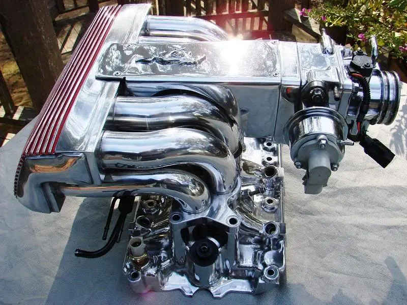

If it were me... I'd find a GT-40 tubular for a fair price, polish that bad boy and bask in my own good fortune.

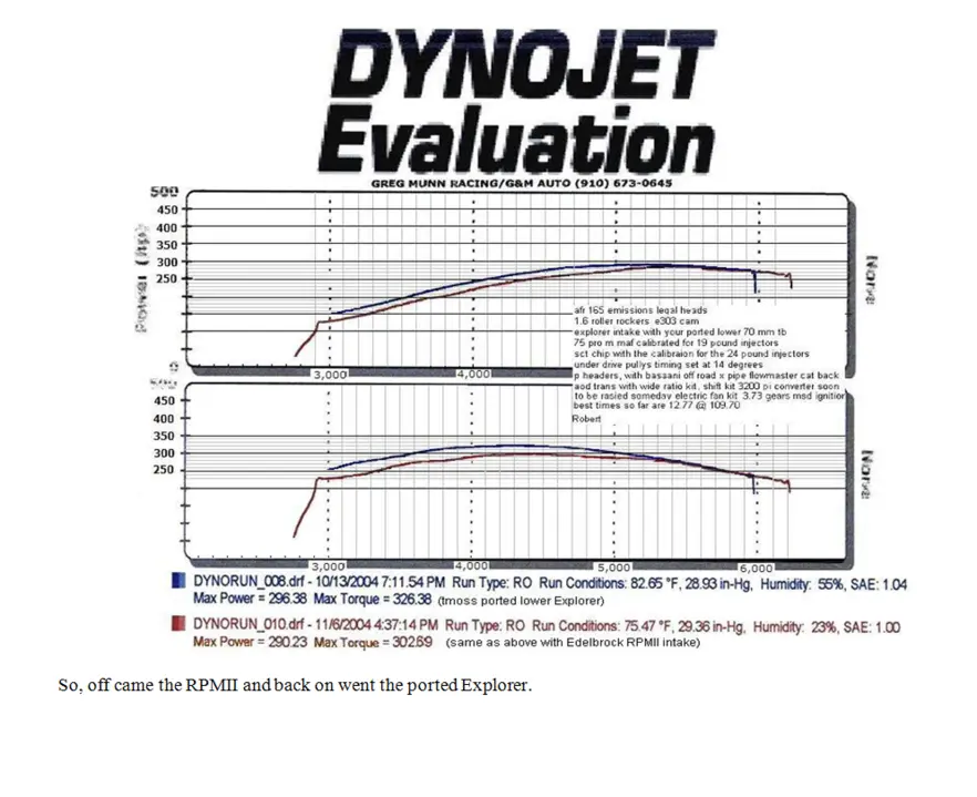

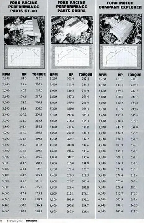

Or for about 1/4 the price, an Explorer intake. You will get nearly identical performance.

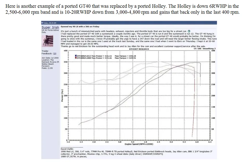

The explorer intakes flow just a hair more than the tubular GT-40 intakes, per Tmoss. Here is some other interesting info.I see them go for about half. Mike is right though. They flow about the same as the tubular intake.
Sorry, those were two seperate thoughts:...and not ported.
