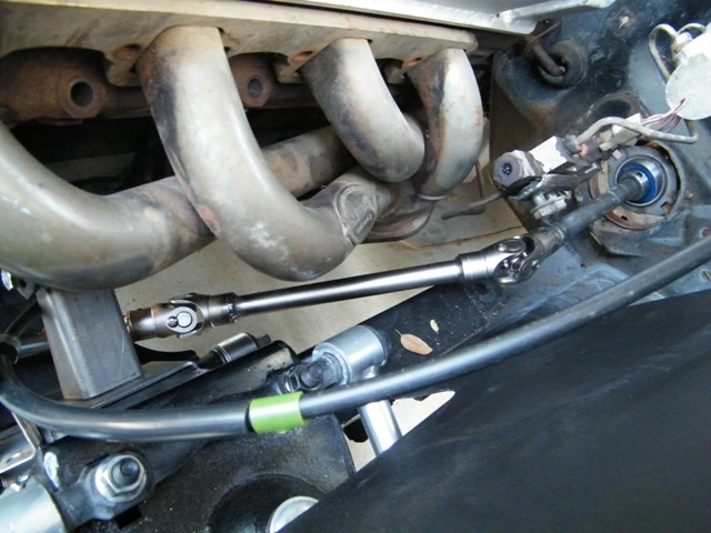

I will be, on a glance it looks like both the tube and the shaft will need to be cut a good 5 or 6 inches, possibly more, after cutting(and doing all the lower bearing stuff I plan on buying a couple 3/4" steering u-joints of of Ebay or somewhere to weld onto the shaft on one end and bolt to the rack at the other...then all I would need is a straight piece of 3/4" steel...if it will angle the way I want...I might possibly have to add a 3rd U-joint and stabilizing rod end in there somewhere, so the lower bearings I will be using, u-joints, shaft, rod ends, etc will all cost me roughly $200 if I do it this way, and I was wondering why Heidts charged $250 for the kit...its probably better for me to buy the kit and let them take care of all that...but I enjoy fabrication(and besides I'm not going to pay that for a kit that I cant see a picture of what all it contains)

I can buy a smooth 3/4" ID u-joint that I can weld to the stock shaft....as for the column tube support thats what the flanged bearing from mcmaster carr would be used for...better than just a support(I assume that column support doesnt have a bearing built in...but its just an assumption since I havent seen any pictures)
I finished welding the steering components together today. The steering is very tight absolutely no slop at all. I had to weld the lower u-joint right to the 9/16 -26 coupler to get my angles right. Cant wait to drive it...
