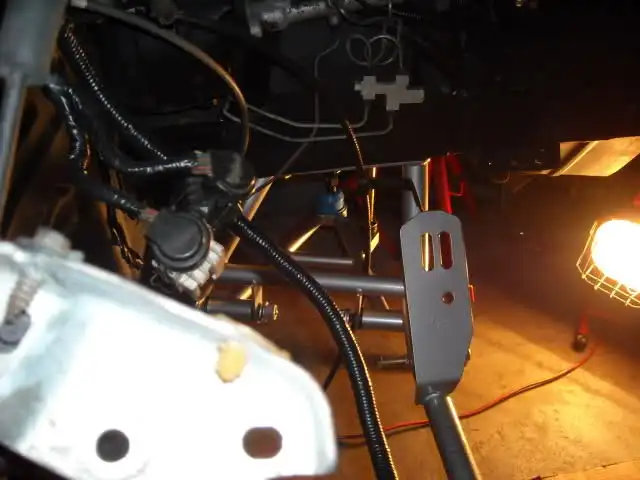

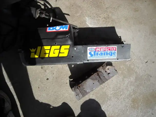

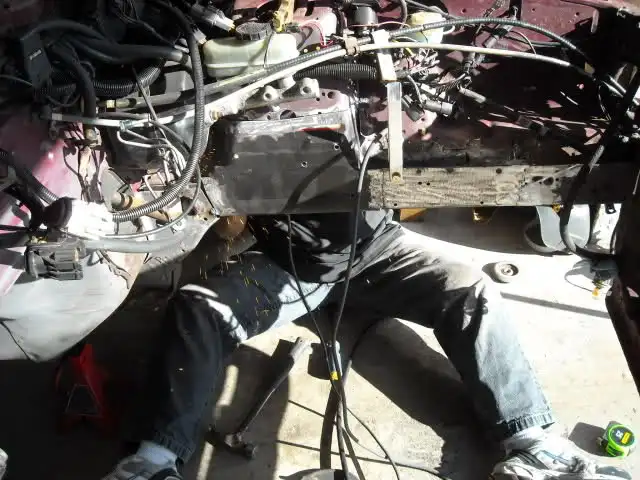

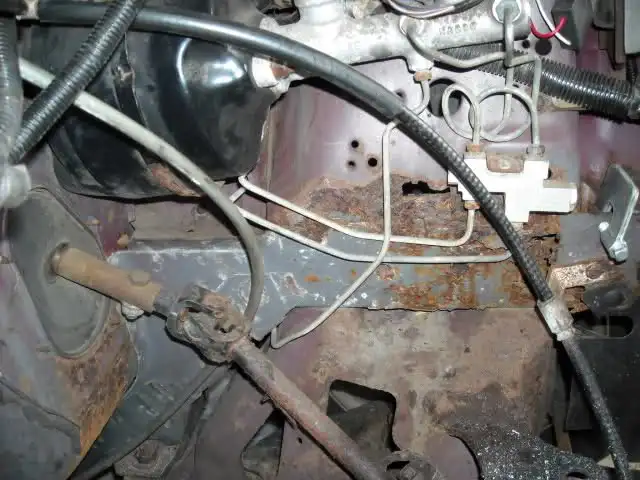

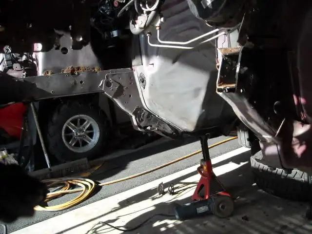

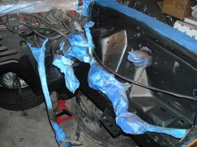

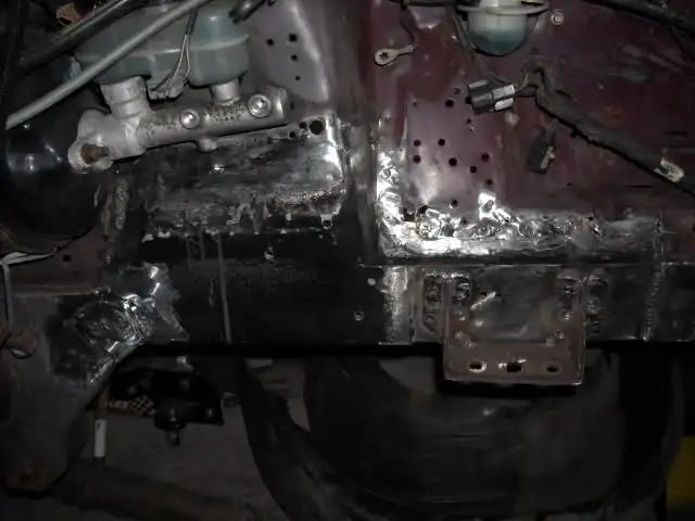

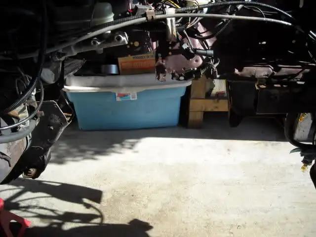

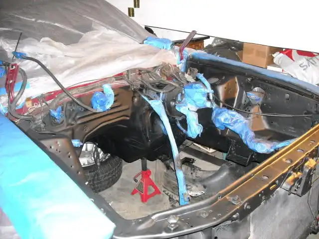

Here is mine..pretty bad
this was all fixed last year and holding up very well cant even tell it was repaired!
Did you take from a donor car or did you just put sheet metal in and shape it around existing tower? I have to do this soon myself and trying to figure the best route to take

Did the ones on my last Fox, gonna need to do the ones on my current Fox. I don't see what the panic some of you guys are expressing is about....it's an easy fix? Even if you just patch it with some sheet metal.
