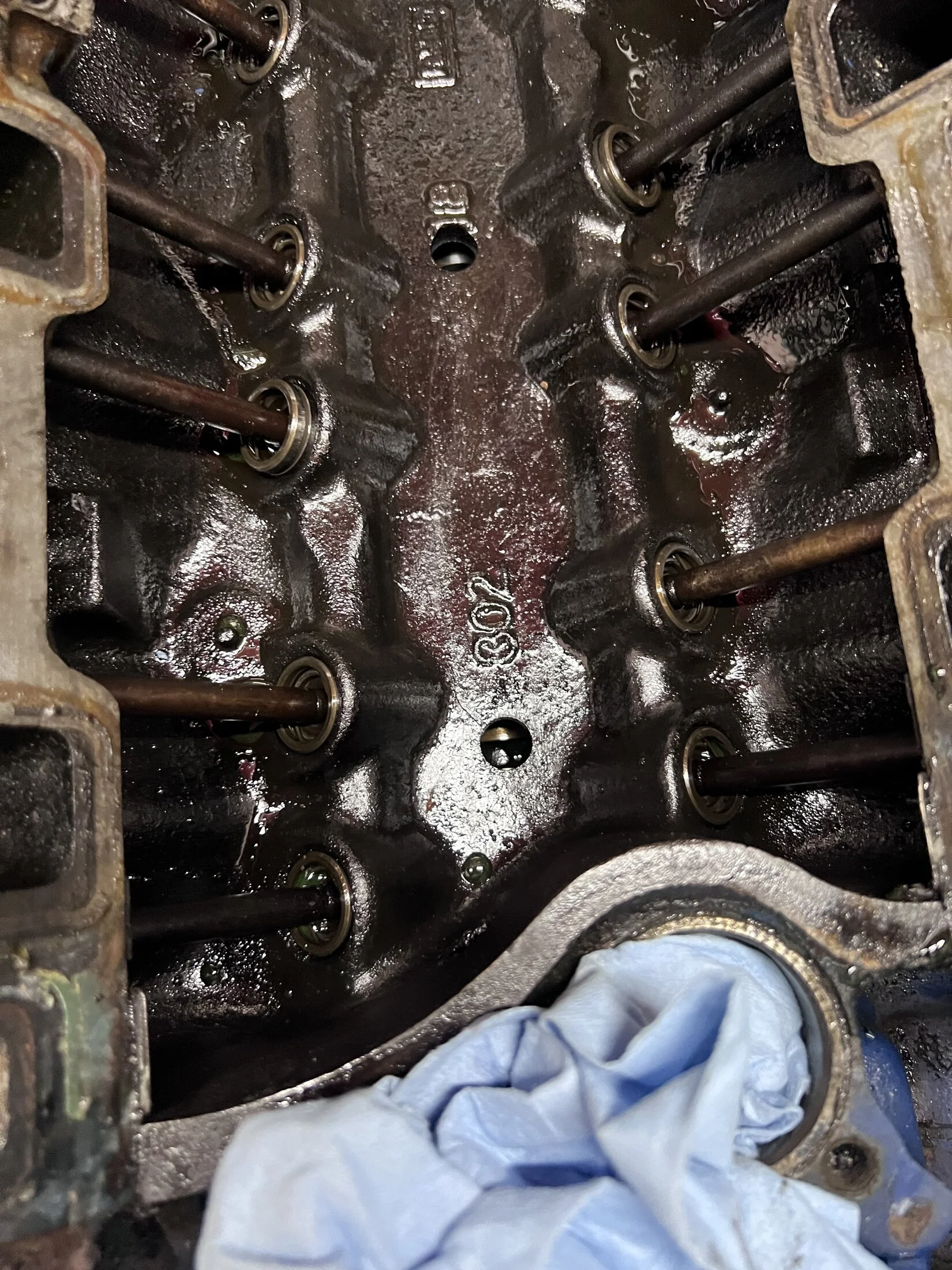

I inetwebguy New Member Jun 13, 2024 3 0 1 Florida Aug 18, 2024 #1 Aug 18, 2024 #1 I was converting my 289 from a 2bbl to a 4bbl and when I had the intake manifold off I noticed this 302 stamp cast into the well. Is this just a coincidence or is this 289 actually a 302? Attachments IMG_5124.webp 641.7 KB · Views: 172

I inetwebguy New Member Jun 13, 2024 3 0 1 Florida Aug 19, 2024 #3 Aug 19, 2024 #3 Thank you. Mine is a 66, so clearly not the original block. Now to find out if it’s just the block. Thoughts?

horse sence 15 Year Member Nov 29, 1999 12,536 8,598 233 Wile Coyote's stunt double Aug 19, 2024 #5 Aug 19, 2024 #5 Yes. A 289 says 289 in the lifter gally ,however ,they are actually the same block It is the stroke that makes it a 302 ,you need to check the crank and rods to see if 289 or 302 Reactions: 89ripper
Realmongo I prefer to be called "Evil Genius" Founding Member Oct 10, 2001 2,466 86 99 Western Mass Aug 28, 2024 #6 Aug 28, 2024 #6 A lot of late 289 production engines used the new 302 blocks.
