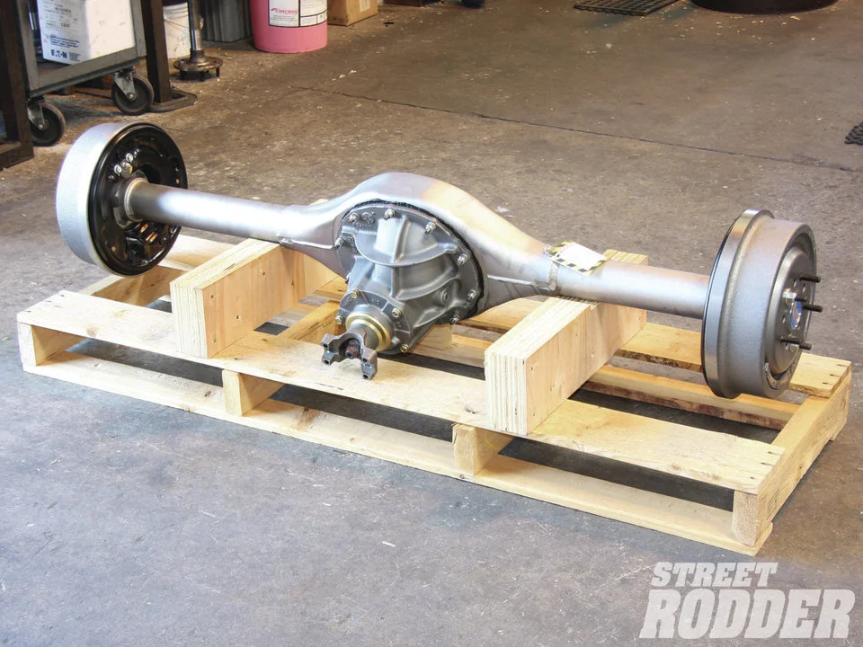

I have currently aquired a rearend and the tag is gone. I was wondering if it is a 9" or a 8"? I looked all over the housing and only found these numbers: 3L12.... 86M... and WAT.... Do they mean anything?

ok first, are the edges of the pumkin scalloped? specifically around the bolt holes. if so then you have either a 9 or 9 3/8" rear end
second, can you get a socket on the bottom nut? if so then you have either an 8" or 9 3/8" rear end. if not then you have the 9" rear end.
here is a picture of a nine inch rear end;
look close and you can see the scalloping around the bolt holes.

Thanks for your help... I definatly can not get a socket on the bottom nut, had to use a wrench...

definitely a 9" then.
