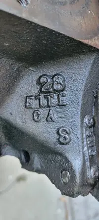

Is this a good block to start with?
bigbros93
Oct 31, 2011
15
14
Orlando, FL

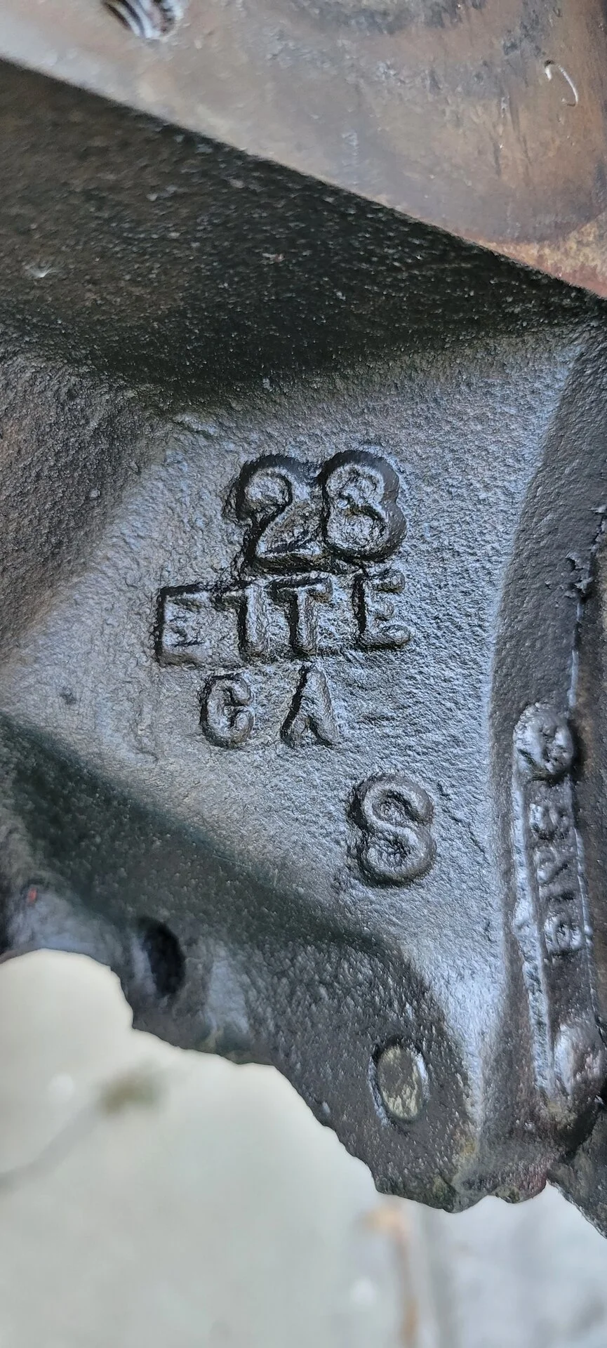

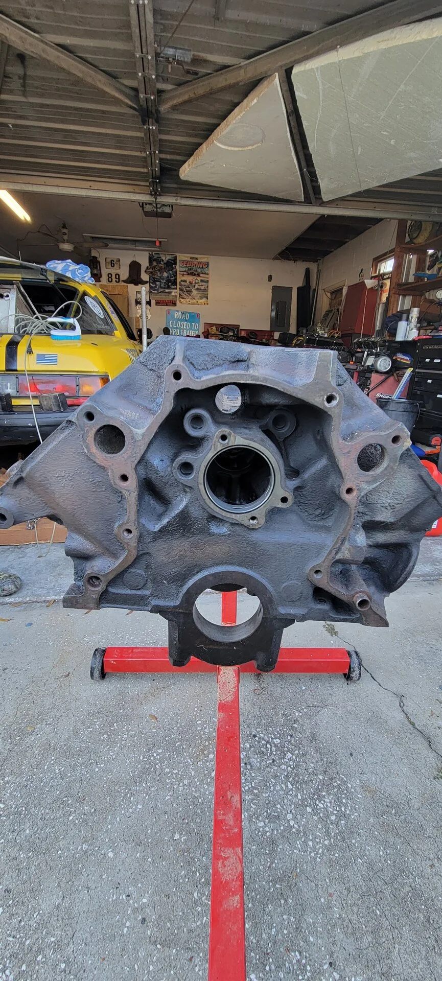

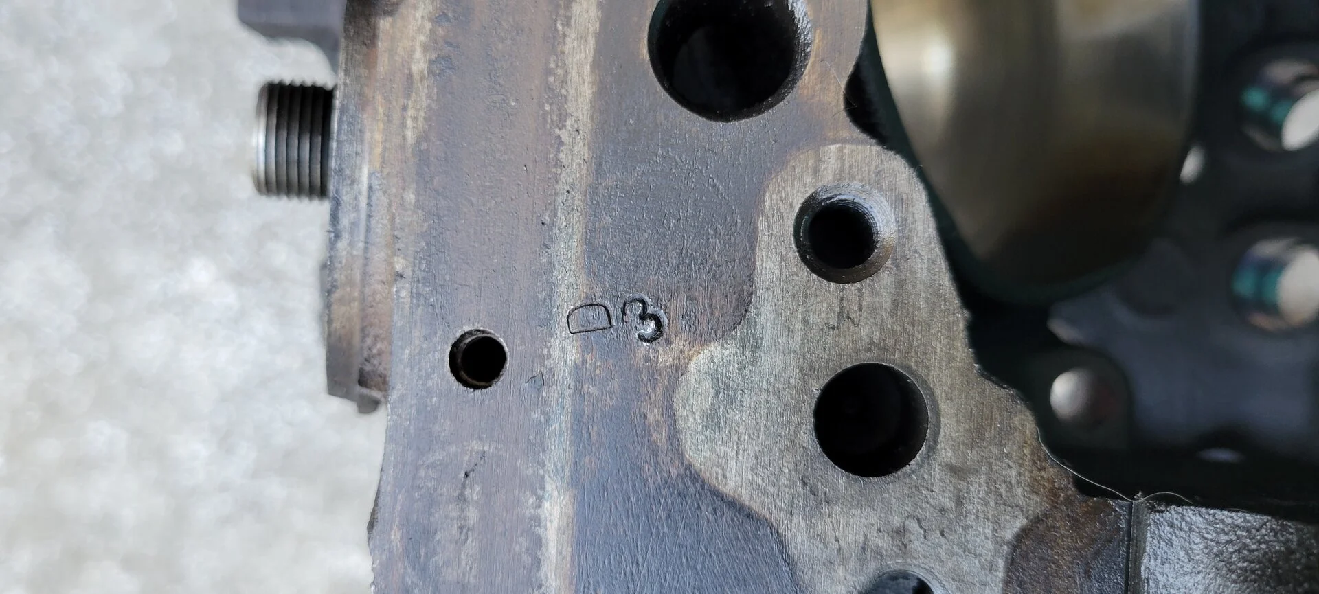

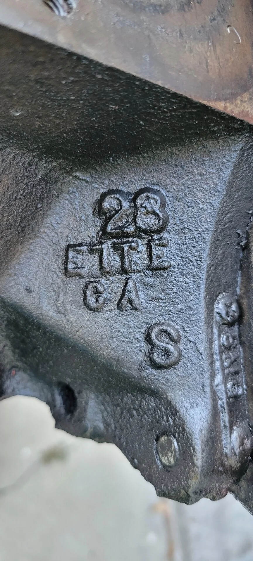

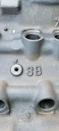

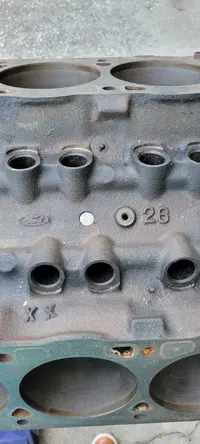

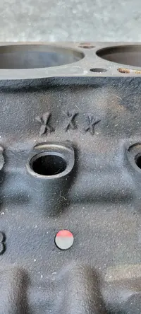

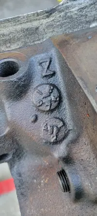

Hey guys, so.ebody is selling this block for $100. They said it was from an 87 Cougar and I got the following pictures of the codes. Is this a good block to build and engine from? I'm thinking of a 347 stroker kit and eventually using it for a weekend driver. No racing or anything like that. Let me know what tou think! Thanks in advance!

To expand on my original post, I currently have a 93 LX which I cut my teeth on. Now, I thought a 302 would be a good engine to try my hand at building one. This will be my first time doing this and would eventually like to put it in a roller down the line such as another fox or 60s Mustang. Thanks!
E7TE is the standard 87 up roller block. If it checks out (magnaflux, not already 40 or more over bore, a bunch of broken off bolts and studs etc.), it’s plenty for your purposes. It should require some notching of the bottom of the bores for stroker clearance.

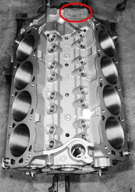

On the top-rear of the block, behind the lifter valley, there is a flat pad. On that pad was stamped the last eight of the VIN of the vehicle that the engine was in. If that can be posted I can tell you which vehicle it was in.

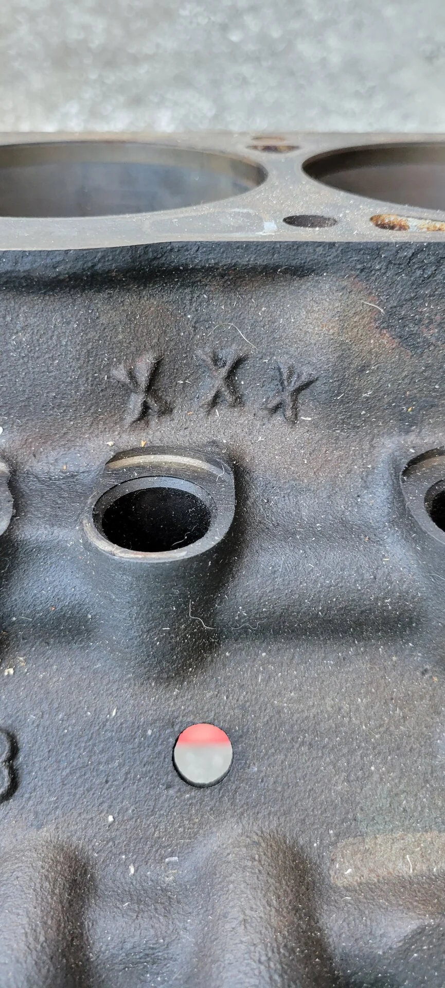

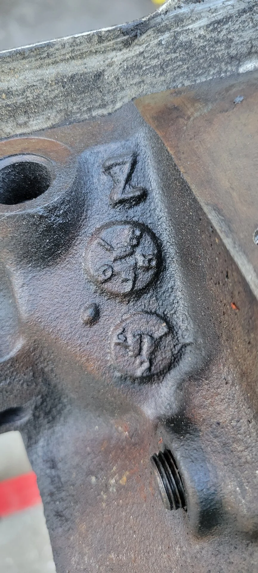

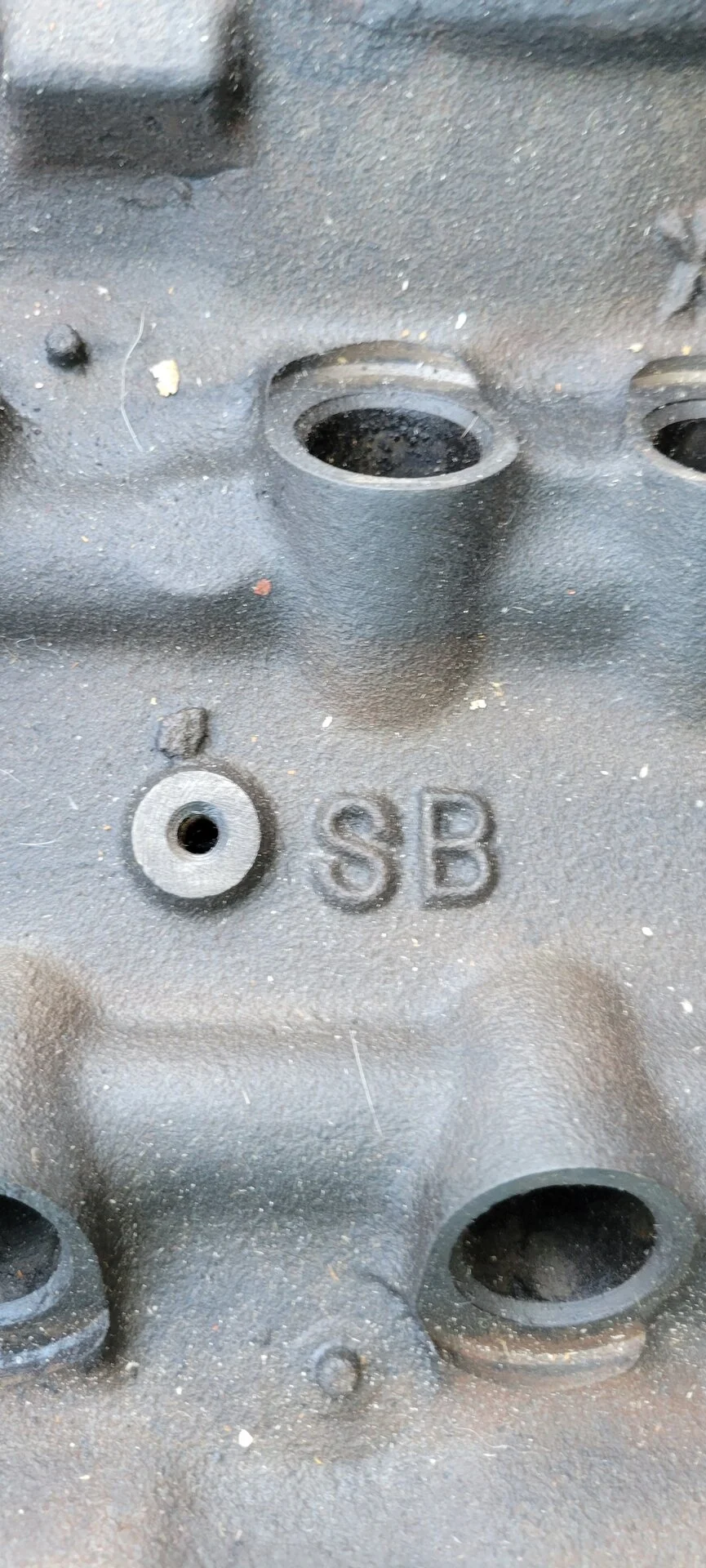

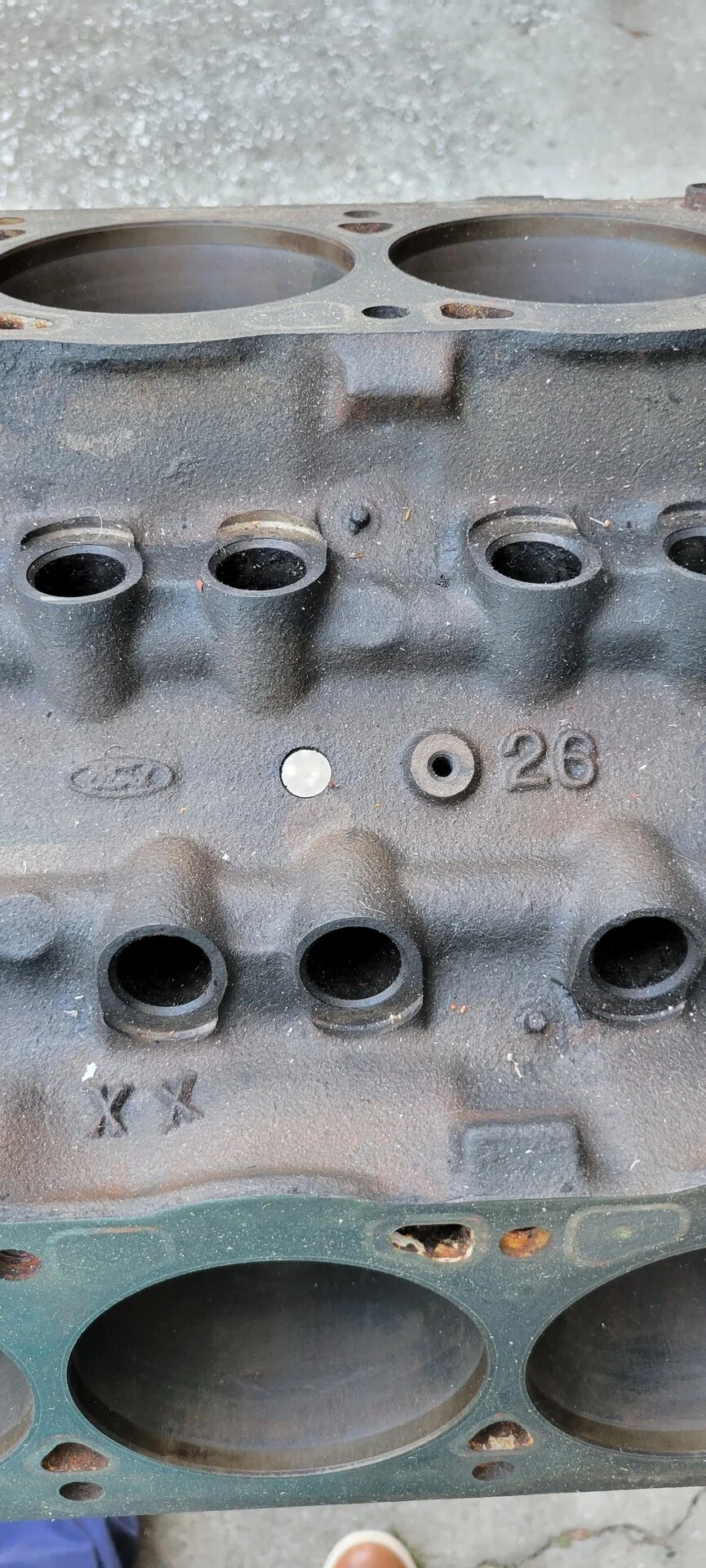

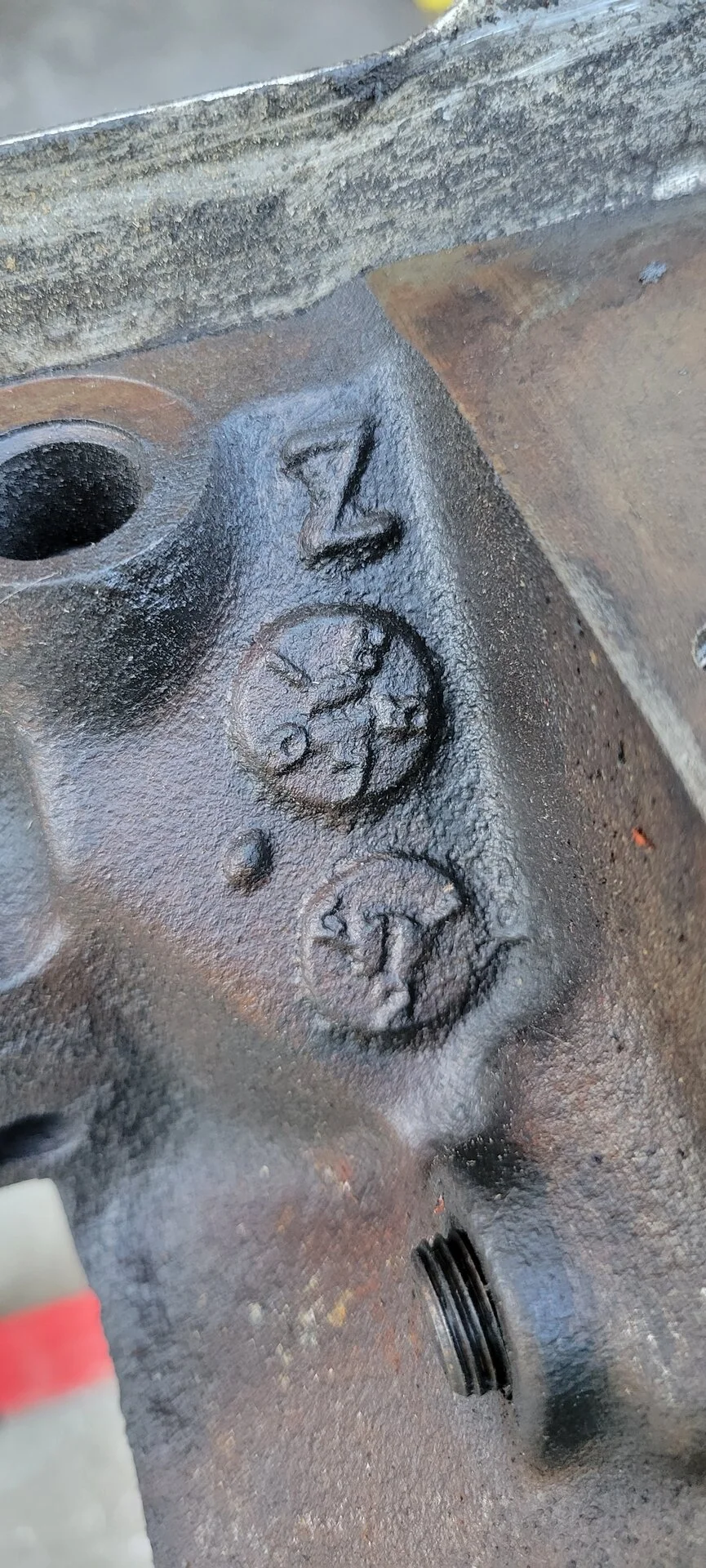

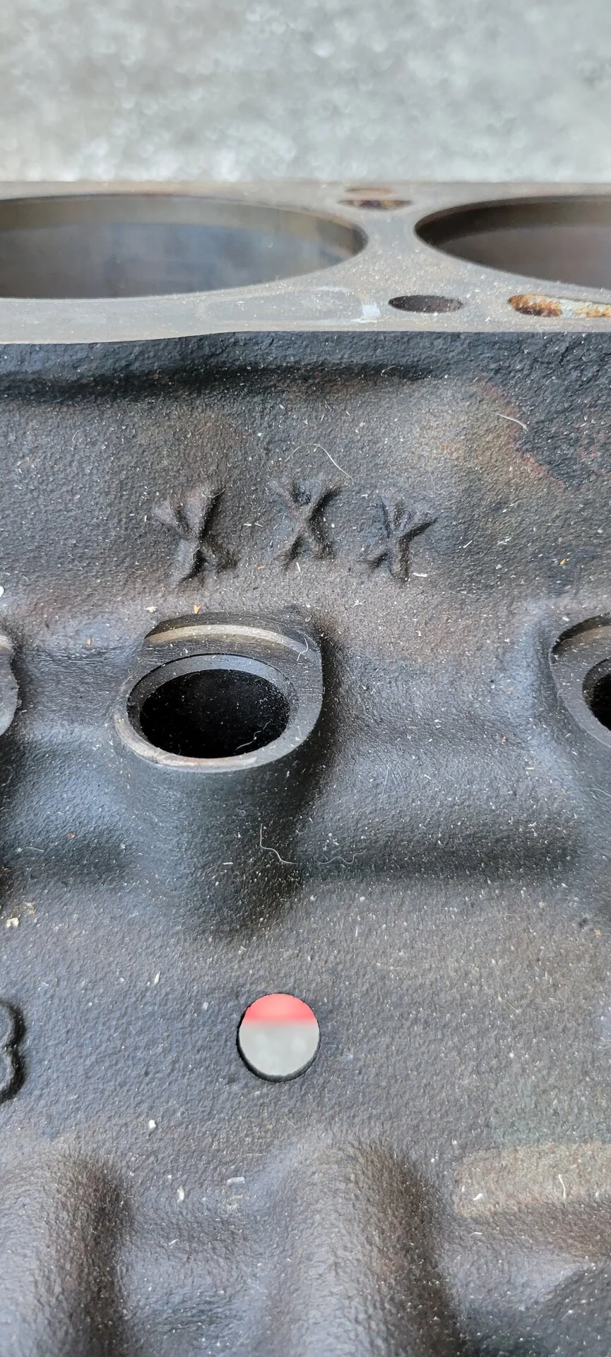

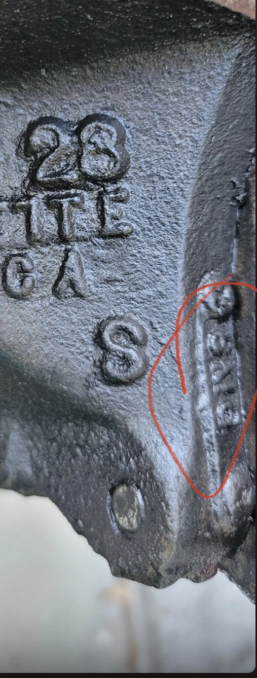

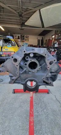

Thank you everybody for your replies. Attached are the rest of the pictures I took in case there is anymore info you can share from them. I've asked the guy to send me a pick of the last eight of the VIN as well. Thanks again!
Oops. Here are the pics.

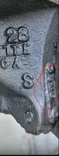

E7TE is the 87-91 block. 1991+ Got the F1SE block.
This is the date code. If you can tell us what it says I can tell you when the block was made
I think this say 8A16
If so, that would mean Jan 16, 1988 was the day that this block was cast.
Just to add. Assuming the block checks out with no defects, I would use that as a starting point.
