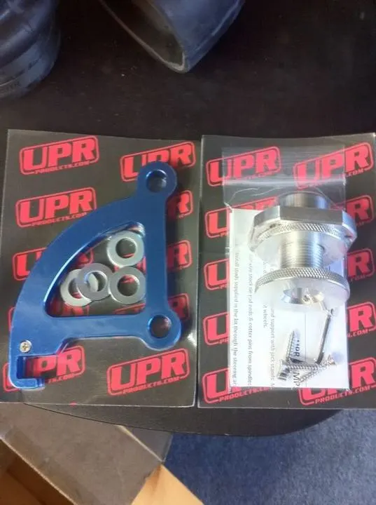

Hard to say if that's an adjustable cable or not, because there are so many different ones. The Maximum Motorsports cable is not an adjustable cable per say, but requires a firewall adjuster which you buy seperately, which makes it adjustable. The adjustment screws would be on the clutch fork not the firewall. That's the only way to tell if it's adjustable.

That's exactly what I'm saying. You can always put a firewall adjuster on there, but it only serves the purpose of making adjustments without having to crawl under the car. If you go under the car, on the driver's side of the bellhousing, there is a metal dustcover with one screw at the bottom. That little screw should be a 10mm nut. You remove that dustcover and the outside end of the clutch fork along with the cable is extended out of the bellhousing under the dustcover. If it's adjustable cable it will have a threaded end with two nuts on it where it grabs the clutch fork. If it's not adjustable, it will just have a little end on there that is not adjustable.

I would be much happier to see a STOCK cable, the adjustable stuff is garbage. I bet if you swap out to an OEM Ford cable, the pedal feels much lighter and smoother. You could then do a firewall adjuster (if you have an aftermarket quadrant), and never have to climb under the car to mess with it again.
