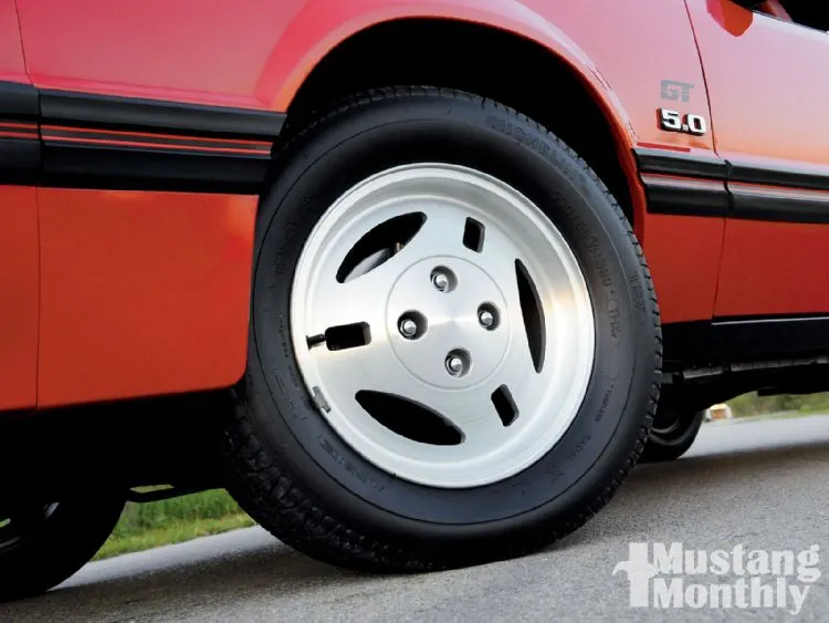

In 1985, the wheel of choice was the 15x7 "phone dial". There was a time that those wheels were actually desirable, believe it or not.
