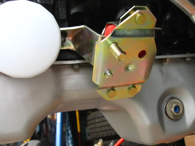

This is the driver's side mount, the stock ones look like the bolt is in the center but on these it looks like the bolt is on the top??? is that how they are?? will this lower or raise the engine??

I think thats how mine went. Dont forget your engine ground!

that's how they go on a fox. passenger side stud is more towards the center though. energy suspension mounts lower the motor about .5" i believe.

I had to take mine out because they raised the motor high enough that the hood hit the turbo. I would like to have used them but raised everything to much.
Paul
what brand was that?

I don't remember what brand but they looked identical to the ones in your pics. If the car is there with the engine, take one off and check to make sure the little tit is in the right spot for that side. I remember having to change mine when I put the engine back down.

So will i have issues with these mounts??? will the driveshaft still fit ok if they set the engine back?? they are supposed to be like the convertible mounts, how much do vert mounts lower the engine?? will i have issues with my bbk L/T's hitting the ground?? My car is a vert by the way in case the k-members are different.

My new mounts raised my engine slightly. I just figured it was the difference between the old worn out rubber in the stock mounts, compared to the new polyurethane.
http://www.blueovalindustries.com/products.php?pid=592 - bought them through ebay for a bit cheaper if I remember right.
