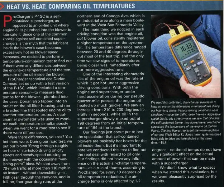

You are way wrong on the Procharger running hotter because it's self contained. A recent magazine article tested both the Vortech and Procharger for internal temperatures (in the head unit) and the Procharger was averaging twenty some degrees lower temps and only came close to the Vortech's temps at idle speed, so watch what you tell people on the threads as it's bad information. The Procharger comes with the intercooler because they charge about $1000 extra for it and all blown '05 up stangs should have one for certain.

I would like to read that article. I am just going by everything I have read and heard from not only these forums but tuners as well.
There's a lot of bs out there you know? I mean, if you think about it the Procharger is just a gear box spinning in it's own oil. The only heat generated is from the friction of the gears and bearings and some heat from the compressed air charge. The others have super heated engine oil running through them in addition to the heat that's generated by the blower itself. The Procharger uses about a zero weight synthetic oil which also reduces friction compared to the hot engine oil in other centrifugal blowers.
I'll try to find the article and post a copy or more info from it.

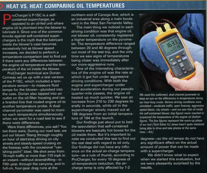

Here's the article where they show the Procharger runs anywhere from 20-40 degrees cooler than the brands that feed oil from the engine.
