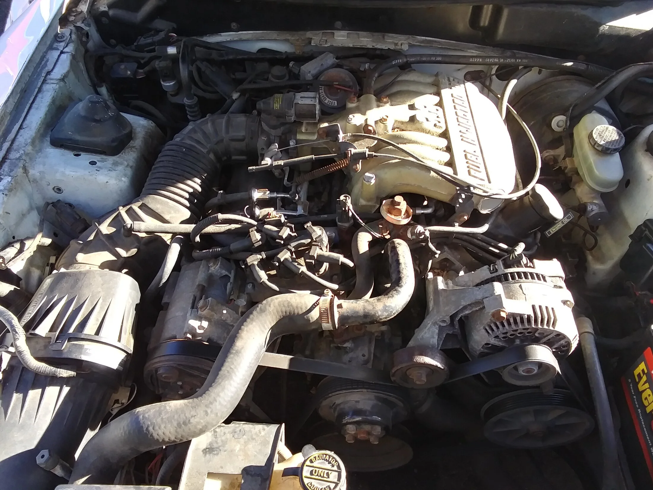

94 Convertible, the Essex 232 V6 in it looks different than photos I've seen, location of air intake and distributor are different as well as the distributor being rectangular instead of round. Replacement engine I guess and I don't know what to think about that.
Also, distributor seems to be connected like:
1-2-3
5-4-6
Seems strange.
Now today, stalls immediately upon start. Want to check plugs and injectors, no repair funds yet but I'm wondering about the distributor. Any thoughts are appreciated : )

I'm woefully underequipped, so no codes.
I was mistaken; the cables were in the right order.
I'm missing a 5/8 deepwell for the plugs but in the meantime I pulled the cables and cleaned the posts and sockets with alcohol. #2 had moderate corrosion.
After that, "Pony-Boy" isn't stalling and sounds almost normal, but I think it's probably misfiring. It hesitates slightly when throttle is applied and wobbles lightly. Intermittent low idle, possibly only when engine is hot.

I've had it about a month and the symptoms are:
Turns over too much before firing
Stalls immediately after firing
Doesn't turn over too much or stall immediately upon 2nd or 3rd attempt
Sometimes low idling and misfiring for about 5 to 15 seconds after starting, then RPMs go up to about 1500 and then drop right away to normal (800). Which makes sense, just need to address reason for the misfiring.
Today what happened is that it didn't recover from faltering and instead just kept stalling, so immediately that it was basically like not starting. But I believe it does fire, just stalls right away. Aftet I did what I described earlier, it went back to only stalling after 1st or 2nd attempt. I do realize that could be a coincidence.
Also, when driving, it hesitates slightly (goes to stall but doesn't, makes me think) when throttle is applied from stop. And it seems it lacks power at the bottom of 1st, starting out. Acceleration is normal above that point.
I need to replace plugs and have someone see if the injectors are fouled or malfunctioning. And also look for vaccuum leaks and wire issues, indeed : )
I know just a little and I think this car will be good for learning with.
It does have a EDIS module and a CMP where the distributor once was IIRR
