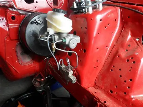

So you talking about plugging off the brake line that runs to the rear of the car. The location that you want to do this at is at the proportioning valve? It’s the piece below the master cylinder that all the brake lines go to in this picture:

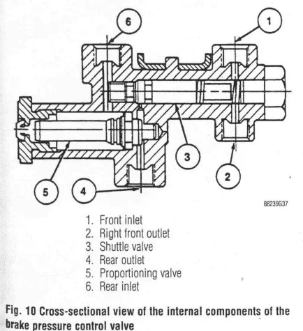

Which port are you trying to plug? My guess is #4 in this diagram:

Yes

That is a flared tap so a bolt will never work. So the Fox cars do not have any metric fittings on the brake system. The proportioning valve has 7/16"-24 and 3/8"-24 but I cannot tell you which one you will need. You can literally buy a 12” long brake line with those size fittings on each one. Cut the one in half that fits it and then hammer the line flat on the open end. Fold the flattened part in half and hammer it flat again. This should seal it so it will not leak. Install in the bottom port and it should be good to go. This is not a permanent fix but I have used ot to get out of a jam a couple times in my life.
