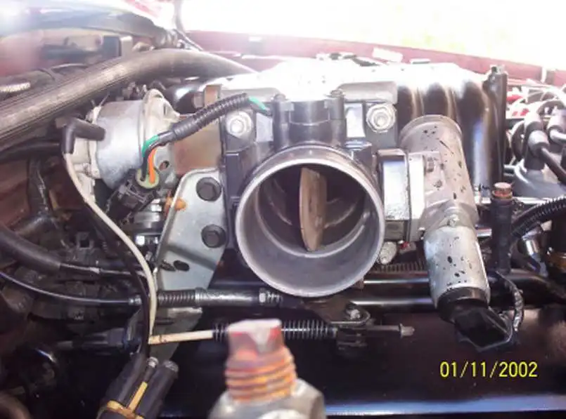

Is this WOT?
Nottoofast50
Dec 9, 2000
386
Cali
This is what my tb goes to with the pedal to the floor...
9250stang said:
You may have just flooded your engine. :nice:
and then immediately cleared the flood. :D
FWIW, the puter sees WOT as a TPS reading of 3.7 volts or more (there are different 'WOT's'). :)
