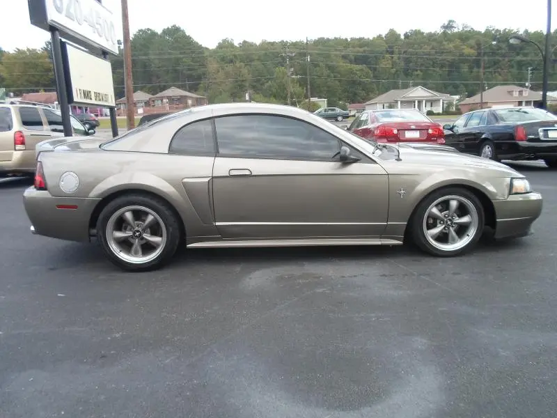

I just bought my car saturday. 2002 mustang bullitt clone. There is some information I will post later with all the mods and what has been done to the car that I know of. But as of right now I have a major issue.
I do not know how much it is lowered but Im guessing 2-2.5 in rear and 2.5-3 in front. It has a nitto drag radials on the back. 315/35/17 they are new and was on the car when I bought it. Heres the problem. Im sure most of you already know what Im going to say but I will list the issue any ways...
Any time it flexes or I snatch it in to 2nd gear the right rear quarter panel is squating so much that it is cutting the tire. It hasnt done any serious damage yet (IE leaking tire) But it is cutting the tire up really bad. I will post pics of everything and everything I know about the car tomorrow.
Ive been told to put air shocks on it and keep them as stiff as possible, Its got a weak spring, Need to raise it up half inch, and even to notch the inside lip of the fender well and bend it up <not a good idea if I say so.
Id like some incite on the issue and opinions from the people here. Also of course put 310s or 305s on it. But like I said these are brand new... I was going to upload a side pic of it but it will not let me.
Theres a side pic..
Also its not doing it on the driver side. Only the passenger side of the car. But I know that the motor spins clockwise and the power is sent in a way to make the car flex to the right.

Theres a side pic..
That sucker is definitely lowered quite a bit. Some pictures of the tire would help. Typically it is flashing that cuts tires on these cars. I was running a spacer and had the same issue. To solve it I trimmed in the inner liner and went down a size in the spacer to fix it. Also, I might suggest getting adjustable rear lower control arms or getting a good thick isolator in the rear to lift the spring just maybe a quarter inch to eliminate the rubbing.
I will post a pic of the tire tonight after work. I was thinking of adding half inch spacers in the rear and trying to raise the front as well. I have not had this car on a lift yet but I will this weekend to see what all is done to the suspension. There is alot of money in this car. Going to do a welcome post with all the info on my car and will put a link in my sig. But yeah the inner lip of the fender is whats doing it. I have seen people talking about fender roll but thats not something I really want to do. But yeah Ill throw some pics up of the tire tonight.

The front is especially slammed. I would not keep it like that. Id change the springs.
The rear is very low but not extreme. I would look for a part number on the springs. If they are just a crap choice then buy new springs. If the springs are fine and the shocks are done then buy shocks. I suspect :poo:ty choice of springs by the previous owner. Could even be some coil-cutting stupidity.
It has the bullitt emblem on rear and bullitt panels where the doors open up at. The springs are black on the rear and front. Possibly cut but I dont think so with the work that is done to this car, Just doesnt look like someone took shortcuts with it. I will see if I can tell if they are cut or if I can find some reason to believe they are aftermarket. As of right now Im thinking just going up half a inch with the whole car and getting new shocks all the way around. If the springs are cut I will just buy new springs.
I've been looking around for springs for my car for a couple of months now and I don't ever recall seeing any manufacturer make that low of a drop. He may not have cut corners, but it sure does look like the springs were cut. It's easy to tell, just count the spring coils. I believe the stock springs have 8 coils.
It has the bullitt emblem on rear and bullitt panels where the doors open up at. The springs are black on the rear and front. Possibly cut but I dont think so with the work that is done to this car, Just doesnt look like someone took shortcuts with it..

Ok I just read through the other thread (congrats BTW) and noticed that it was originally a V6 car. It could quite possibly be that the car still has either the stock V6 springs or aftermarket V6 springs (obviously rated for a V6) and the added weight of the V8 is causing the front end to sag :shrug:

Yeah I will be taking the bullitt stuff off. But arnt the rims bullitt rims too? Or bullitt style at least. I dont want to lose the rims. I like them to much lol. But I got under as much as I could today and counted 9 coils on the rear springs. Saturday morning its going on the lift just to see what all is going on. Ill take pics of everything and post back. To me it looks as though someone heated the springs to lower them. The coils are almost touching each other and some are kinda wider then the rest like they are bent out of place.
Any suggestions on a good set of springs, shocks, and struts. Not the best, but not the worst! It has caster camber plates already. I would like to do a good bit to the suspension as well. A full package would be nice but Ive seen them for 800+ and Im not spending that money just yet unless I have to. And I want to keep it lower in the front then the rear. I always liked the stance of lower in the front.
Loads of stock GTs had those style rims. Just take off anything that actually says "BULLITT".
For springs, H&R Supersports are a good choice. About 2" drop. If you want less drop then Ford C springs. I like KYB AGX shocks. Bilsteins are popular too.
