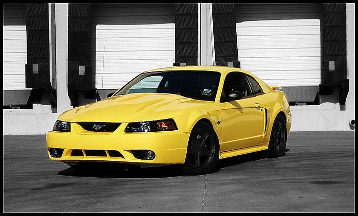

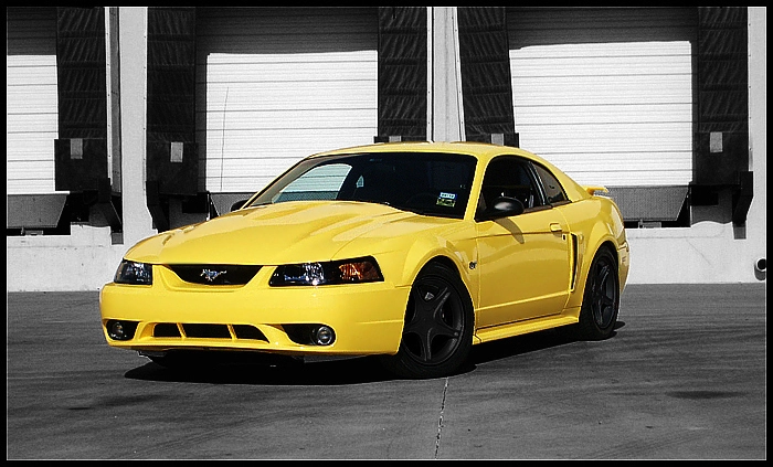

Heres my car with H&R super sport springs (1.75" drop front, 1.6" drop rear)

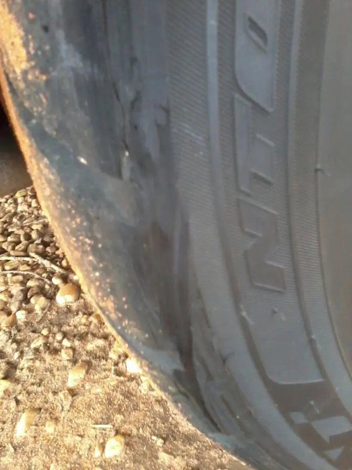

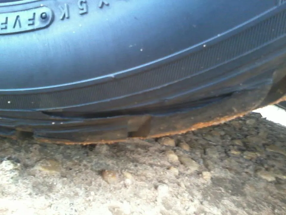

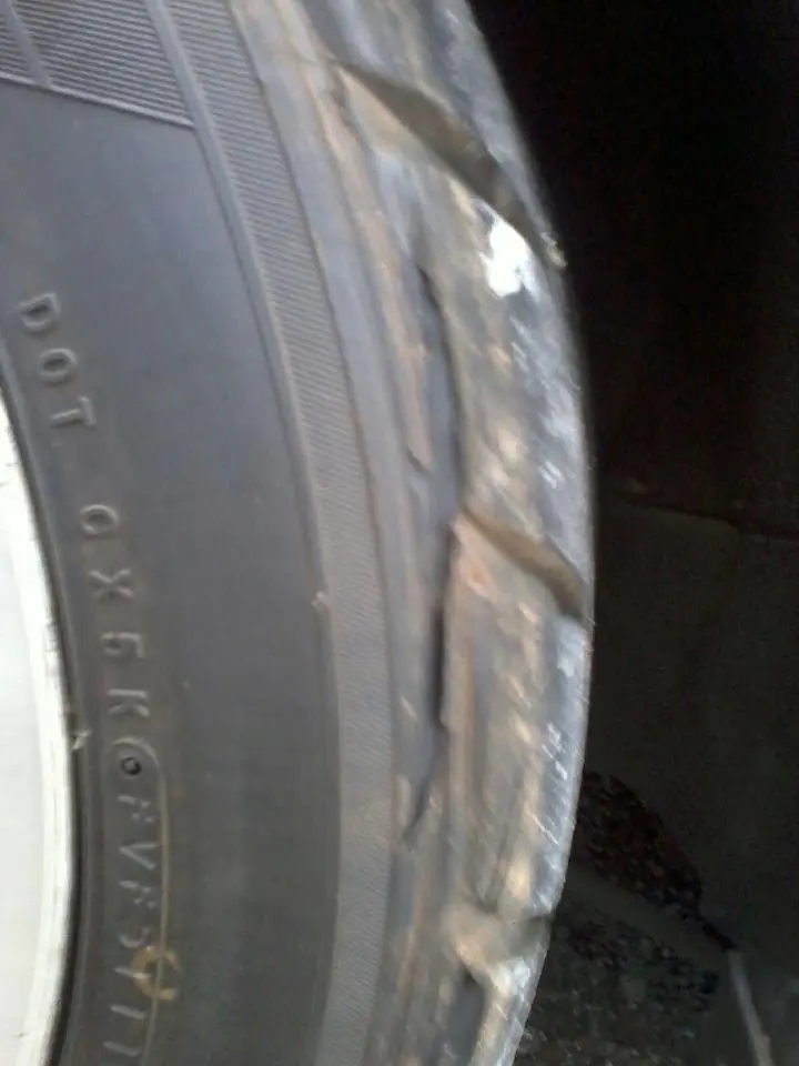

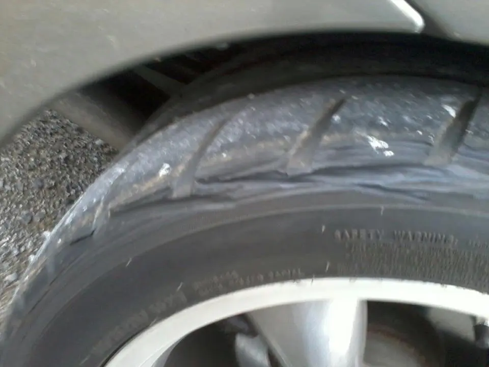

That looks good. I just want to get rid of the wheel rub. I want it to be low thats for sure. Id like to be able to tell its lowered more in the front then the rear. But yeah Ill take the bullitt stuff off the car.
All you need to do is roll your fenders.You can do it yourself with a baseball bat and some heat...Its easy and it will stop your tires from slicing .Do a google search on rolling a fender.

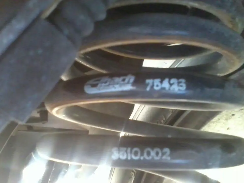

Well I got under it today. Not on a lift but I wanted to see what the springs were doing. Its going on the lift tomorrow. But its got eibach springs... I uploaded a pic of them. Someone told me to go to advance auto parts and buy some aluminum twist spring spacers.... Not to sure about that. I have uploaded some pics of the passenger tire and the spring

Well, it looks like it is a Pro Kit spring setup. Make sure the fronts are the same. (Eibach). The Pro Kit shouldn't sag like that, so you might want to look around locally for some decent used lowering springs.

I wonder if they are right part number for the car? Pro Kit shouldnt be that low. The front defo shouldnt look like that.
Eibach Pro Kit did have a massive sag problem years ago. Tons of folks tried to get their money back. It was the rear speing that were sagging badly over time.
Do the springs have rubber isolators on both ends? If not you could buy some nice urethane isolators that would buy you about 1/2" of extra height.
To the OP, just search on CL for a new set all the way around. Buy something with a name brand i.e. H&R, Steeda, BBK etc. Just stay away from used Eibach's. Older Eibach springs sag (and sometimes break, compromising the spring rate causing an awful ride.)
