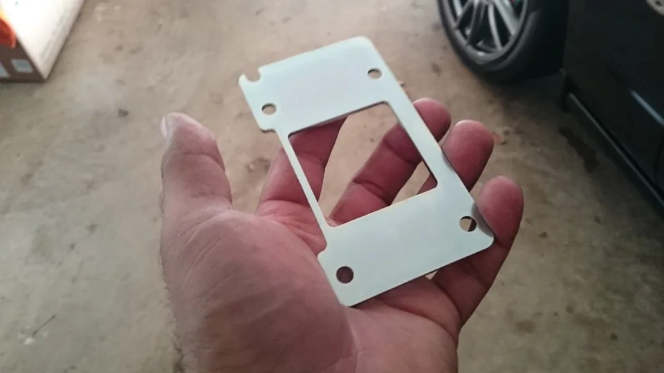

Just curious... is this supposed to be installed between the shifter and the base? It would make sense that this would keep the ear from going into the lock out.... I didn't see it anywhere in the installation directions....
Did Steeda resolve your problem? I have their shifter and bracket and no issues but mine didn't come with the part in your photo. They show it on the Steeda site but it's not referenced in the installation instructions which are also available on their site.

Yes and no Lenny. The plate IS supposed to be installed, and like you said, is not listed in the directions. If you look on their site, they show the plate as part of the kit. ALSO shown are four bolts. These bolts are required because the stock bolts are too short with the the plate installed. This is ALSO not in the directions and NOT in my kit. I'm back on the stock shifter because I don't have these bolts, and I've emailed Steeda through their site but no reply. I'm usually VERY busy during the week, and often don't have time to call, but it seems that's really the best way to get a hold of them.
With the plate installed, I could tell that the shifter would not go into reverse. If you don't use that plate, going into reverse is virtually a given if you move too far over to the left from neutral. Kind of dangerous, my wife drove the car and actually went into reverse at an intersection almost hitting someone.
I just need to get a hold of someone and get those bolts. I hope Steeda revises their directions to account for the need for the plate and bolts...
You might want to try Tim from Steeda. He's active on another forum and seems to be responsive.
tim@steeda.com
Is it possible the reverse lockout spring is not installed or not working properly? From what you describe it seems the shifter reverse lockout "ear" is not touching what the Steeda instructions call the "boss" and so there's nothing stopping the shifter from going into reverse. Maybe that's what the plate is for - to lift the shifter higher so it's blocked until you press down to engage reverse. What year is your Mustang? Mine's a '13 and mine didn't come with that plate but I remember reading that Ford had modified the shifter box - maybe that's the reason for the plate.
Hopefully you'll get it resolved but shame on Steeda for not updating their instructions and for not getting back to you quickly. There's no excuse for either.

Yes, the plate raises the ear so you would have to press down to engage it. The spring is functional, and aside from missing this instruction and the bolts everything else is just fine. I agree. This could have been avoided with proper direction, especially for those of us who aren't full blown mechanics or engineers. Once I saw the plate it made perfect sense though. What's worse for me is the time I need to take to fix it, once I get these bolts. I'm talking some time this afternoon to get myself together so I'll be calling Steeda today to get those bolts, then I can realize the results of all of this.
FWIW, I'm back on the stock shifter, and the NVH from the blowfish bracket is still present, but very much reduced.
Once you get it sorted out I think you'll be very happy with the shifter. I installed mine with the Steeda bracket using the black bushing. No more missed shifts and the throw is perfect. I was thinking of getting the blowfish bracket so please post your review after you install the Steeda. Did you consider getting the retrofit kit for the blowfish? http://tinyurl.com/pymqc8o

i have the same shifter and i never had the issue with reverse but thats bc mine came with the plate and bolts and although not in the instructions i installed it anyways. the real issue i had with this shifter is the rattle and the notchy geras (if notchy is a real word). all in all its a great shifter if your modding on a budget but i saved up and bought the mgw. performance for price is there but if you have the cash or the patience to save then the mgw is better but for double the price.
Also mine came with a stiffer spring that i automatically put in bc i never did like how resting my arm onthe shifter allowed it to go past the ear into reverse

As far as going into reverse, I have done that twice at a intersection, so I went back into it and installed the stiffer reverse spring ,it has been great after that,still notchy though
