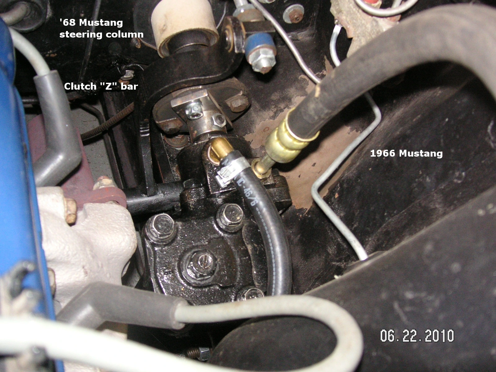

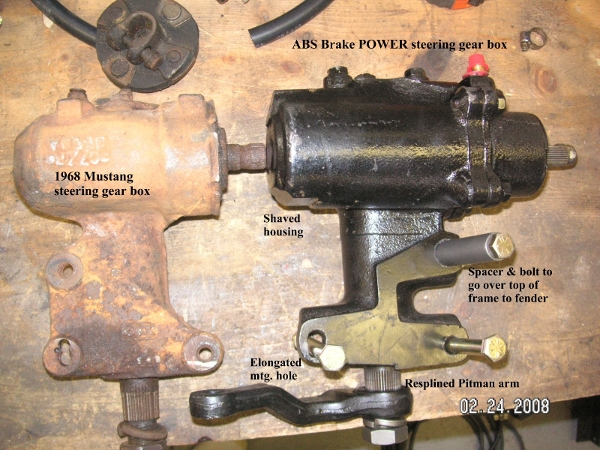

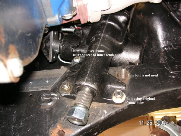

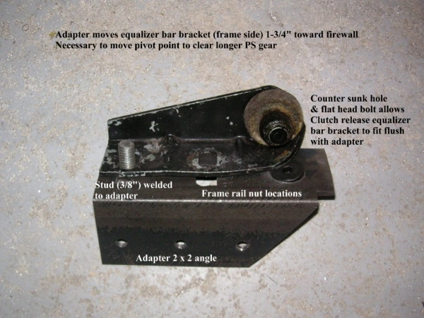

I used the ABS unit on a 1966 Mustang with 4 speed transmission and Z bar. Works very well. I have a complete set of pictures and modifications necessary. The ABS is actually a 1981 Toyota Celica gear box with one mounting hole slightly elongated. Requires a different spline installed in the Pitman arm which ABS does with your original arm. I have found a 1980 Toyota pickup hose works quite well with slight bending and an SAE fitting installed on the pump end. I used a 1968 Mustang steering column which required no shortening. Required a slight modification to the Z bar.
