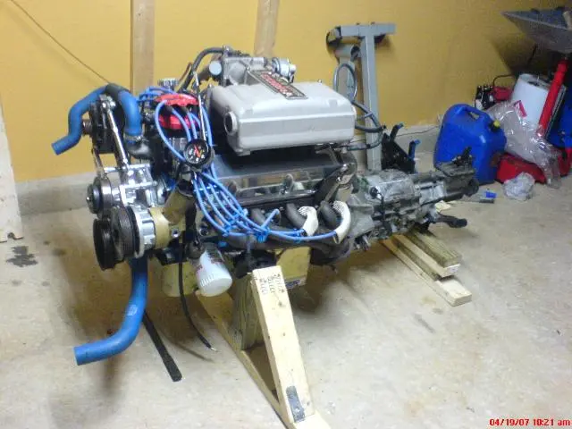

Ive finished assembling and installing the engine. After setting everything correctly, so I thought. The engine idles around 850-900 @ 32psi with 10deg of timing, vacum at idle 15in. When idling it sounds great, steady, with a little lope, no ticking, no hesitation, throttle response it great.
I pull it out of the driveway and it starts to act up. It lurches real bad, pedal very touchy, and backfires/pops through the intake if I touch the throttle, and idles high. When I try to get on it to see if it will clear up its like there is no reaction, it just pops more, if I coast it back to the garage the engine sounds like it is about to stall but keeps above 700ish,
I believe this is caused by a faulty sensor or bad setting , that takes affect in closed loop, but I do not think it has enough time to go closed loop by the time it starts to act up. ( from startup to trouble, no more than 5 mins)

definately sounds like timing or ignition. Recheck that you put the plug wires on the right cylinder and also check at the cap. Sounds like you have one plug wire in the WRONG location. I did this by accident a month ago with my engine and i SWORE i didnt. If that isnt it, restab the distributor again and go through that process
The wires are on the correct firing order. but i will check again .
I dont think it would idle or rev smoothly during initial start up if they were not,
Im finding TDC on the compression stroke by pulling the #1 plug and turning the engine until the goes pphhsssttttt out the plug hole, around 0 deg..setting to 10 degs TDC stab the distributor near #1 terminal,
I did not get alot for troubleshooting time today, but one thing I am thinking of is the deg pointer on the block may be off, Im going to play around with the distributor, try a couple more positions.
Do you believe 850 to 900 rpm is to high for base idle? should I set it lower 750 maybe? I was under the impression this cam liked to hunt(rpm) if the base idle was set too low. ?
