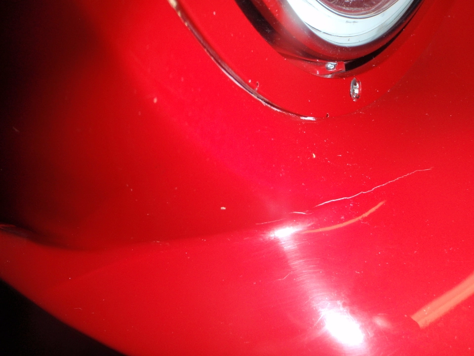

It came outta nowhere. A pothole.
Not just any pothole mind you,...this one was obviously an abandoned mineshaft, as it had no bottom,...(well it seemed that way) The car hit that hole so hard that the entire dash shook like I hit another car.
It was so deep, I actually think I saw a brief glimpse of the Great Wall.
What's the big deal you're probably asking?....everybodys' ran into a pothole at one time or another.........
This:
You can barely see the crack in the paint (and the underlying bodywork) right above the reflection of the flash. It runs about two inches to the right as you look at this pic.
Its just the beginning, water will start to get in there now and fester. I am pis sed!
The car has been sitting since my encounter,...fortunately the $400.00 wheel is still round,...but I'm at a loss for what to do w/ a crack that will probably walk both ways now that it's in an area that I could not weld (The aluminum headlight bucket was chemically bonded to the steel bumper) read.,.... epoxied.

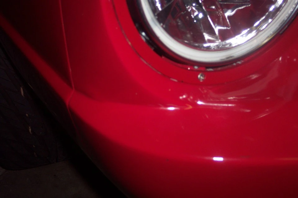

Here it is in all of it's miserable detail w/ a real camera:
(i need to do a better job of detailing the wax outta places it doesn't belong in,....sheesh.

Stop drill and fill Mike.

I would at least do whatever you can temporarily do to seal up the crack to keep any moisture from finding its way in there. The permanent fix does seem like it's going to be a w hole lotta work unfortunately

The problem with that little crack, is that the foundation under it (the steel weld surface of the bumper, bolted and glued to the aluminum headlight bucket, has now been compromised). If it's free to move around, the repair will break back out again the very next hard bump the front end is subjected to....................................
NOW, ....................Do you see my dilemma

okay now i see, I would just convert it to a 4 eye then
I agree,....thinking about getting some clear touch up (like the touch up pens you can get) and keeping the crack filled.
I'm already planning the revamp for the body (how far off that is I don't know,.....sometime after the Webers).
But the new color palate is slate gray and satin black. The interior will keep the same upholstery, but the red will dissapear in favor of the same two tone as the outside w/ the red band in the seat backs and maybe a thin redline showing up as an accent inside.
I'm thinkin' that I'm gonna bring the theme forward 50 years. Kinda mad maxificating the whole thing. Those pretty, shiny wheels will get a black or slate accent added to them as well

Wellll. If you're considering redoing the exterior, fill it in for shows and looks till you get there. Heck, now you got me excited to see what the future holds for your car.

It was bound to happen, Mike.
Touch it up, clear it, buff it out, and rock on. It's hard to drive a show car and keep it a show car... I'd say that it would need to be a lot worse than that before you throw the double blade, though.
And you know I expected it would happen as well, because it's one of the oft repeated questions I get asked by the folks that stop by to talk at shows.
That changed last week. Now even the frame of the headlight bucket is starting to become visible under the paint.
I'm not gonna ditch the current theme just yet ,( yet meaning anytime in the foreseeable future) I'll drive it as is for the rest of the year. The time for the revamp will be before it gets like one of those cars that has a bunch of fiberglass stuck on the sheetmetal that looks great from 20' away, and when you get up close reveals that the bond is breaking everywhere.

IF it were me.. I would grind it out, apply a bead of epoxy, fill, prime and paint. I know its easy to say at the other end of a computer but it honestly looks like a quick fix. I'd pull something crafty with the tape edge foam and blend it or maybe paint the nose on the car if it is chipped. Take a break and get your mind over the loss, then tackle it dude.

I'm over it. ( for now) I will "bandaid" the repair until I'm forced to put on the cap and gown and operate. Right now I'm focusing on raising the necessary money for the next project that nobody on here can/will benefit from. (It's what I live for)
