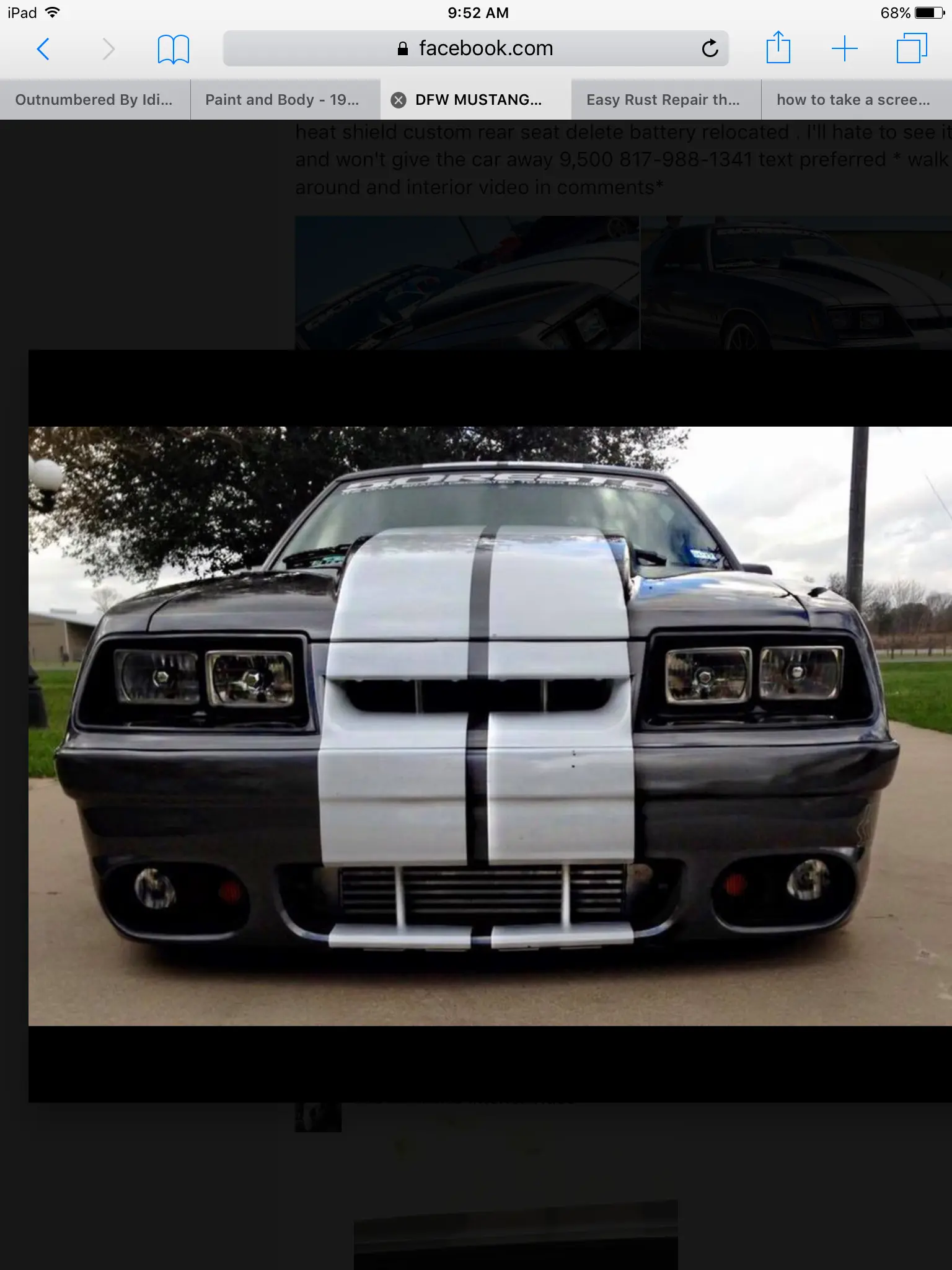

I've posted some information on the 1985 Mustang I "inherited" from my youngest son. This is an ex-show car, featured in Mustang magazines at the time. I even see pictures of it show up on websites, such as LMR.
At first glance, it looks great and has a lot of really custom work done on it. 2004 Cobra front bumper molded into the 1985 top bumper, 1993 Cobra side skirts and moldings, rear 93 Cobra bumper, 1998 Cobra interior, T3550 transmission, 3.55:1 8.8 rear, aluminum heads, shorty headers, FI Tech Go EFI 8 fuel injection, the famous B cam, stock block 302, LED lights, 3" rise hood, Saleen rear spoiler, custom rear seat delete with 10" woofers and amp, wire tuck in engine compartment which has been smoothed, MSD ignition, full 5-lug conversion using SN95 parts, 4-wheel disk brakes, USB adapter for input to the stereo, aluminum radiator, HID headlights; the list goes on and on. Really a very cool car.
A couple things it no longer has; the air suspension and the FR500 wheels. The air suspension quit working and my son put on coilovers. The FR500 wheels were confiscated by my son, so I put my OEM Bullits on it.

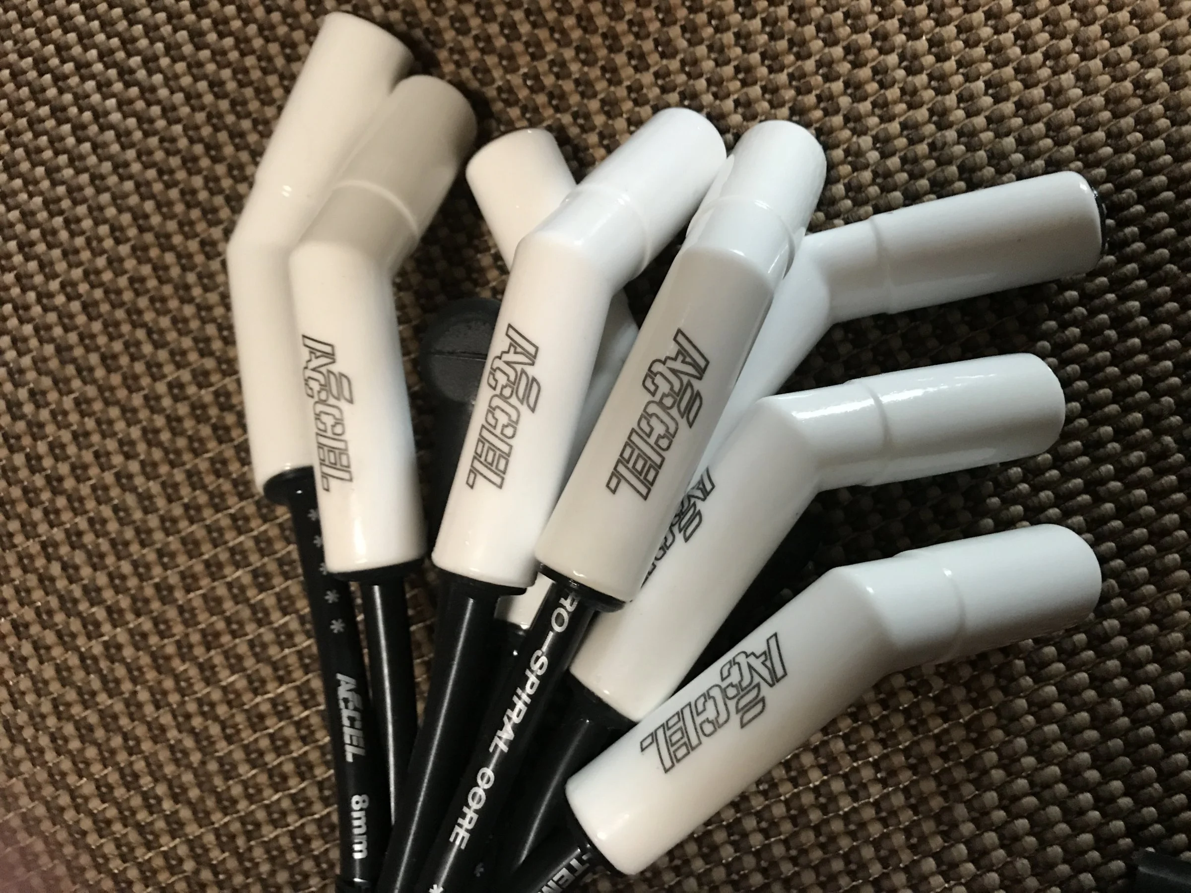

However .......... the car's been passed around from owner to owner and maintenance has been, shall we say, lacking? Initially, the car ran good, as my son (the last owner before me) had put $70 spark plug wires on it with high temp plug wire sleeves. Due to the configuration of the header tubes, within 30 days (not driving it very much) three plug wires had burned through. Not wanting to buy plug wires every month I bought a set of Accel porcelain wires. Problem solved, or not. The second wire on the passenger (right) side would not go onto the spark plug. I found this out as I drove it to work the first time and by the time I reached the office it was barking and puking like it was just going to go toes up.
I decided (incorrectly it turns out) that that if i sanded down the porcelain end of the plug wire that I could get it onto the plug and drive home in peace. Not a chance. I spent my entire lunch hour trying to get that plug wire on the Accel shorty plug I bought. "Shorty" is a bit of a misnomer. I'm certain it is somewhat shorter, but not by much. At the end of the day it was no go. I resigned myself to driving home on 7 cylinders.
On the way home I bought a 90* plug wire for that cylinder, put a high temp booty on it and called it good. I don't want to dimple the header tuber to get things to fit. I'll just run one odd wire.

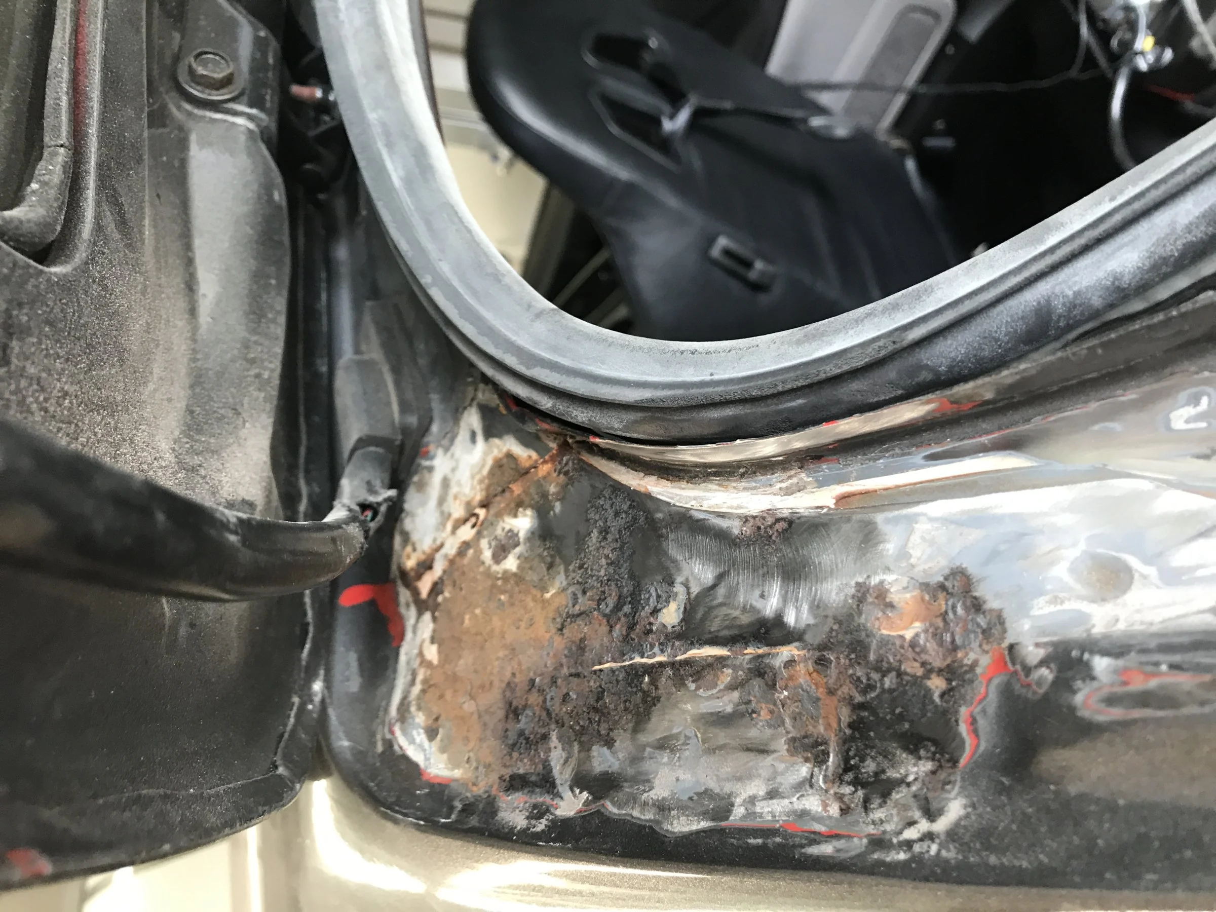

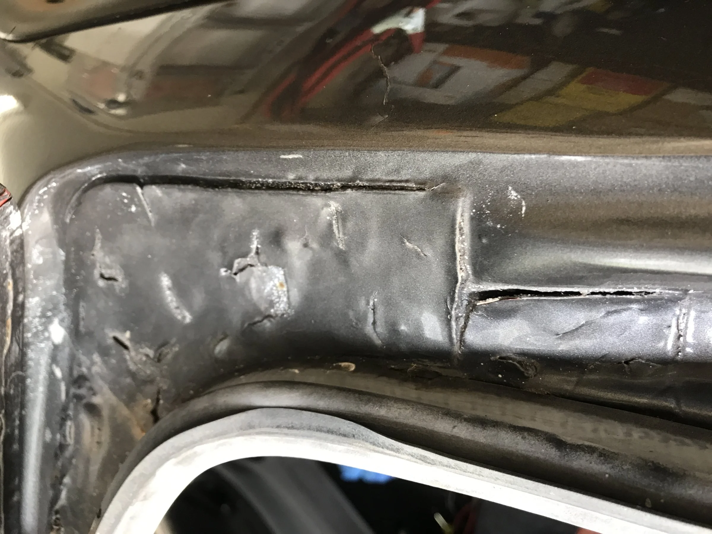

The most serious problem I found was rust under the paint at both body-side corners of the hatch. Talk about ugly! I wire wheeled it to bare metal, which turned out to be sound underneath. I treated it with rust converter, followed by rust encapsulator. I did discover that the rust was under the "original "red paint, not the grey paint. I think this indicates there were repairs made prior to the rebuild. At this point I just left it in the rust encapsulator. There's some other small areas that need attention, so I'll wait and take care of all of them at once.

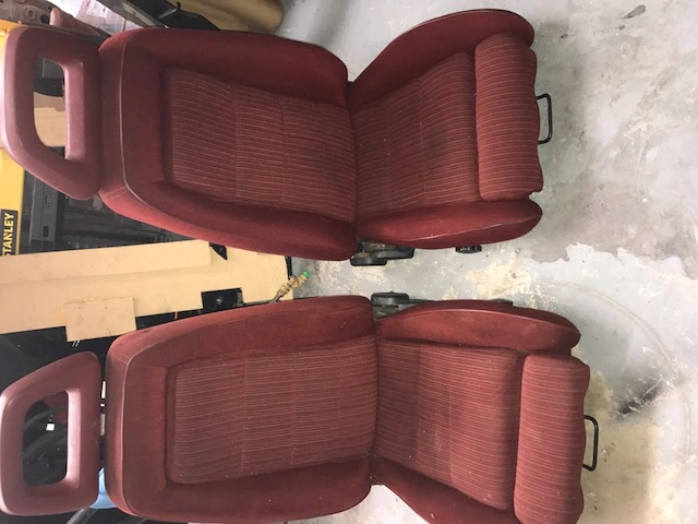

I found a really nice set of 84 GT350 seats. Nice cushions, very nice upholstery, but they're porno red. I'll have to do what davedacarpainter did with his seats and paint them. I put a set of black seat belts in the car, which fit and work perfectly.

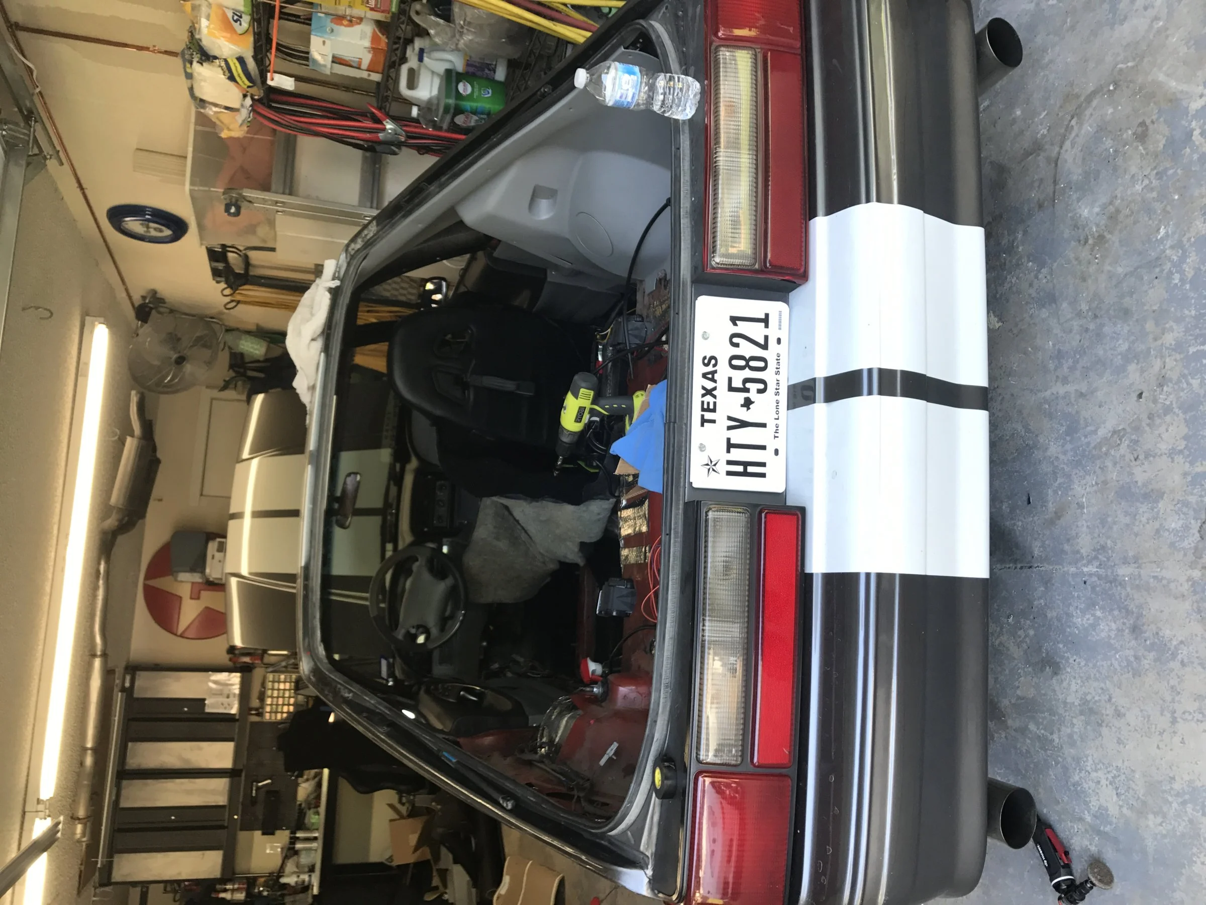

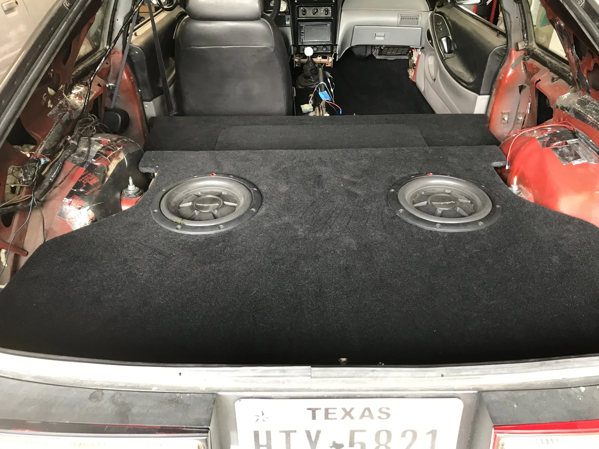

Originally, the woofers were in a set of enclosures sitting loose in the hatch area. I removed them from the enclosures and installed them into the false deck. I think they look a bunch better that way. I'll need to get some covers to prevent them from being damaged.
Since my son removed the air suspension, I bought a 2004 spare tire and jack, putting them into the spare tire well. This wasn't possible with the air suspension in, as it was located in that spare tire well.

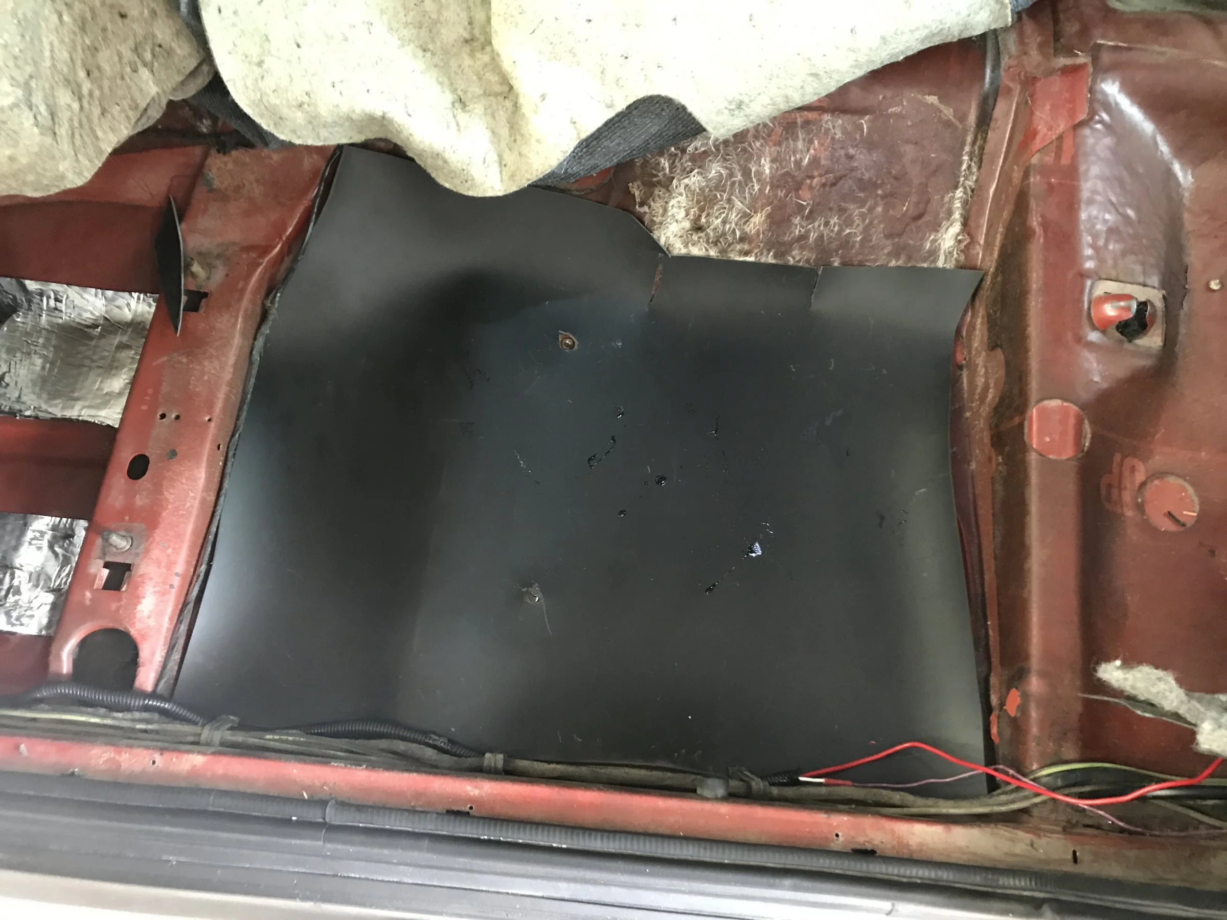

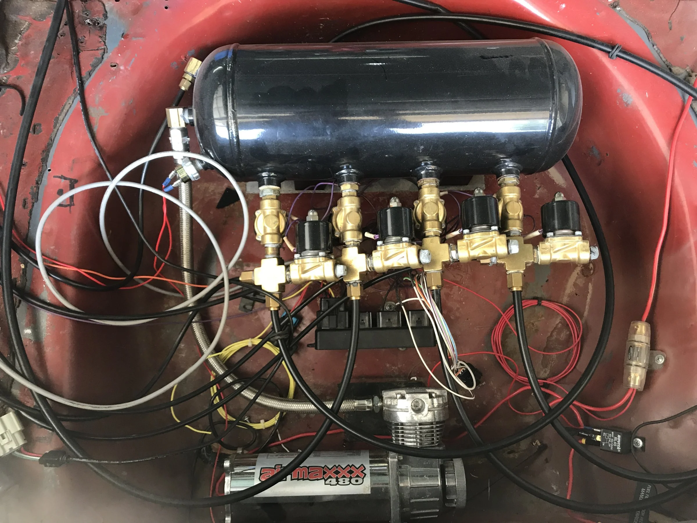

So, the spare tire well was filled up with air suspension stuff originally. Looks like nice stuff, but many parts, such as the compressor and manifold had been changed out over time. I went around and filled all the screw holes from the stuff that had been removed in the hatch area, which were dozens. Didn't want to have rust issues. I also filled the rear quarters with foam to hopefully reduce resonance there, as I couldn't get to it with the FatMat. Time will tell.

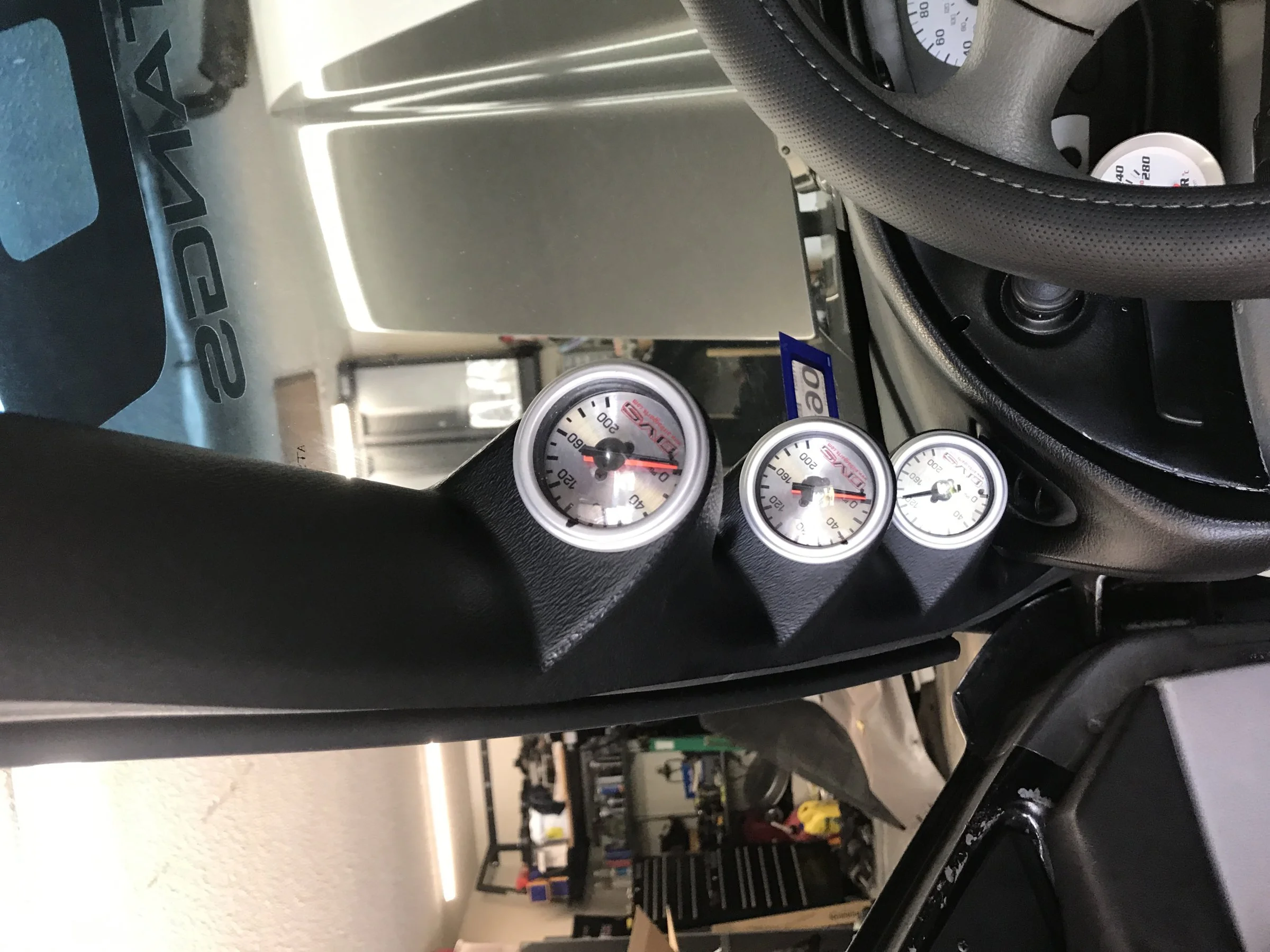

The bottom picture shows the gauge pod that was in it. Because I removed the gauges I now don't have a left A-pillar molding. If someone has one, let me know, please.
Sorry about the sideways picture
