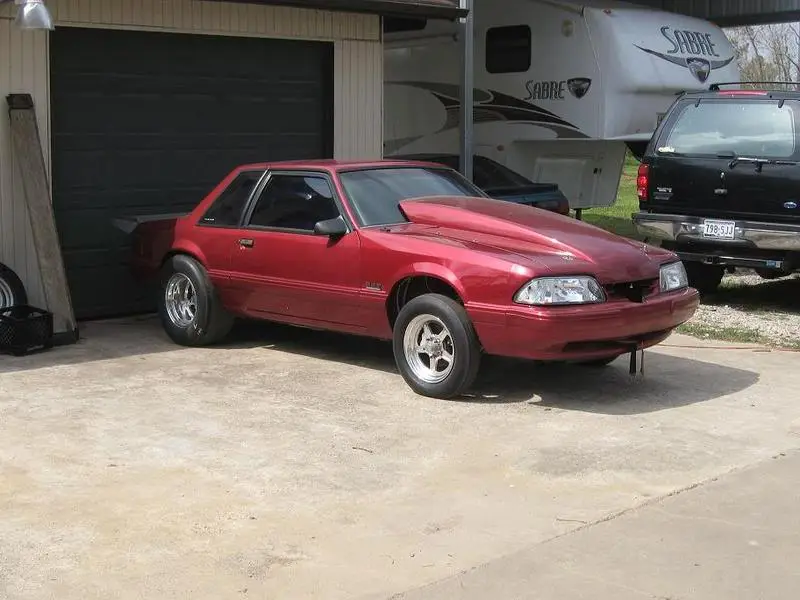

i had a bike wreck about 3 years ago. i had a 05 busa and a guy that had no lic, no ins,not his bike hit me and i was in icu sleeping for 16 days and was in the hos for 45 days. im building a 93 coupe with a 10 point mildsteel cage with a 427r motor from bennett with a glide with a 5500 stall and a tranns brake. i installed a 9 inch with 4:10 pro gears,40 spline axles,spool, and its 6 inches shorter that a stock rear end, back braced powered coated black with a anti roll bar. i have aerospace front brakes and willwood rear brakes a roll controll i installed a shifter that i can wire in to my box and put a chip in the box and it will shift the car at that rpm. i just had the sheet metal work done because the i have a 10 gallon fuel cell in the trunk. im thinking the car will run in to the mid to high 9s on motor and im going to have a 300 hp nos kit. my cage is only good to a 8.50 so the 300 maybe to much
Looks awesome man! Just need to get that motor in now! :nice: I'm a little confused about the accident....you were on a bike too? Good to see you're feeling better. Are you back to 100% or do you still have therapy and stuff to go to? Sounds like you're super lucky!
