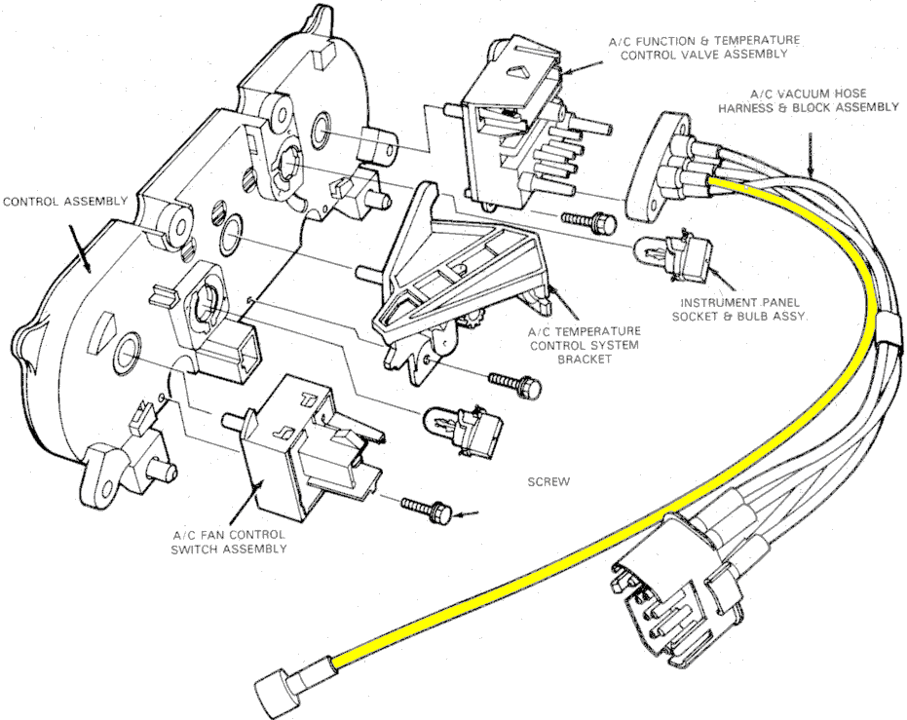

Its still there. Its going from the vacuum tree to the check valve and then in through the firewall. Where does that lead to? I checked the vacuum lines on the back of the controls and there tight. Are there any other electronics that control it? I have all the emissions stuff on the passenger side engine compartment removed, is any of that for the heater controls?
I had the same thing happen to me last week checking for vac leaks again and found that the little plastic hose to the heater controller was cracked where it enters the firewall about 2 inches from the 3 way valve on the firewall. DAM them plastic lines.......
