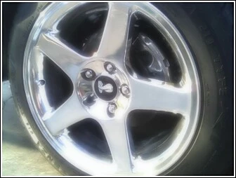

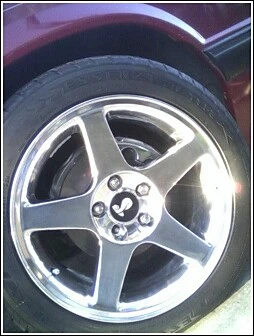

5 lug swap just about done...just gotta get my rear axles.
Ash, your red calipers do look great...but this polished on polished look is Heaven on wheels :banana:

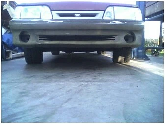

daaaaaaaaaaaaaaaaaaamn those are nice wheels my man. That's a pretty big camber problem. I'd think non-stock application struts could definatley have something to do with that. But with your obvious aptitude for stang tinkering, I bet you can figure it out. If not, any shop with a good Hunter 4-wheel should be able to. Those have to be the shiniest, cleanest, sweetest wheels I've ever seen on a stang. Your car will definatley be a thing of awe when you're done with it.
The camber/toe change is because of the SN95 spindles. Same thing happens when you put on 11" 5.0 brakes.
The toe is easy, You can use a tape measure to set that. Next time you're online, I can show you how to make a camber gauge for under 10$. Trust me, it is well worth it. Caster isn't ajustable from the factory, and if you have CC plates, you just max them out, so no need to worry about caster. A 10$ tool and you can do your own alignments for life. :D

Well for now, i adjusted the camber asfar as i can i believe. i moved the strut as far center (towards the motor) as possible. It still seems to have the top of the wheel out more than the bottom...but it drives pretty much straight so im not sure whats going on here.
Perhaps a set of CC plates would solve this? Also , deffinatly post the pictures...remember your talking to me ;)
Looks great! I'm partial (obviously) to my bright red calipers with my bright red car, but those pictures of yours look totally badass. :nice: Good luck keeping them clean, though, lol.
