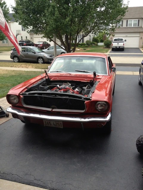

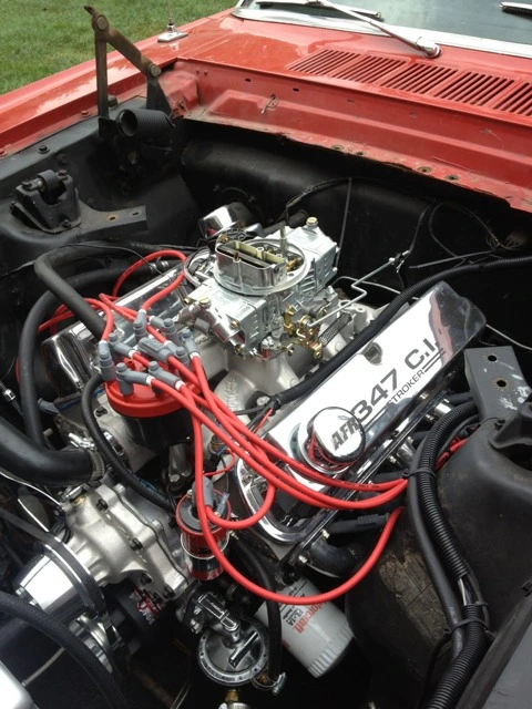

Quite the long project, of a 6 - 8 conversion.
Custom 9"
Built c-4
289 stroked to 347
- afr comp heads
- Ed Curtis cam
- Holley 670 avenger
- Edelbrock air gap manifold
- full msd ignition
- all new steering and suspension
- :poo:..... All new everything!!!!

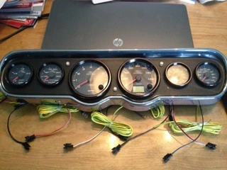

That's one nice looking dash cluster you got there. What are the details?
I had the gauges made by Speedhut with the ford racing logos. the panel I picked up the other day from mustang unlimited. I realy wanted the Billet panel from jmi or whoever makes it. but 6 or 700 for just a panel is too rich for my blood. this setup cam out looking very nice. and it has separate dimmer control.
just out of curiosity what did you pay for the gauges? A local company called "dakota digital" makes a drop in dash that goes behind the stock bezel that looks AWESOME! ...they are a bit spendy tho...but it is a full digital unit with all the sensors included.
