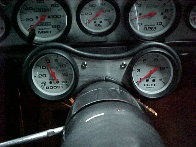

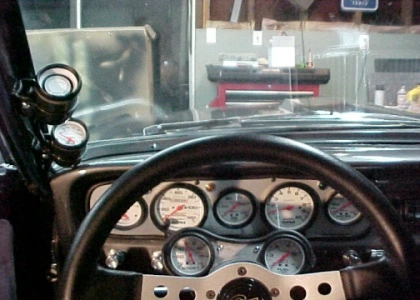

I modified a rally pack to hold boost and fuel pressure for my yet to be aquired supercharger. still not sure whether i'm gonna squeeze the ATI in there or take the easy way out and put a NOVI 1200. but either way. i'll need these to make sure everything is A-ok :nice:

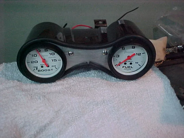

one more
one more of the pack outside the car. i painted it with basecoat clear coat to match the rest of the interior and fab'd the front panel from aluminum to match the panel i made for the rest of the guages. it was pretty easy and i could modify one to fit any 2 5/8's gauge if anyone would like this done to their's. i still have a little detail work to do on it such as straighten out the gauges and actually hook them up.

its aluminum. theres really not any more gauges than a stock setup. only addition is A/F,boost, and Fuel pressure. which is a good idea to have when supercharged. because i used 2 5/8" for most of the gauges in the main panel they take up more room than the small hard to read 2 1/16"
Lemme try this again...."nice kockpit"...thats what my original post said. The workmanship looks good.
As for not many more than stock...mine has 5 guages, that setup has 9. I would be so paranoid looking at all of them...HAHA
