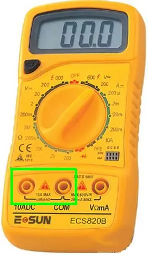

I had a no spark situation which I was trying to diagnose. I made a mistake with my multimeter leads and hooked them up incorrect (bone head move). See the photo below, the green box shows where I had the leads connected, and the switch was on 20 V.
I began troubleshooting for ignition switch and fuse link issues. With these leads connected in this fashion I touched the black lead to ground and the red lead to the (+) pin on the coil. I immediately heard a sound that I can only describe as a pop/boing on the left side of the engine bay.
After I did this I have the following issues:
1. The fuel pump will not prime when the key is turned on. It did before the pop. The inertia switch is depressed.
2. The only warning lights that come on with the key are ABS and airbag. Check engine, brake, batt, etc do not light up now when the key is turned on.
3. With the key on the fuel pump test port on the diagnostic connector is not operational meaning the fuel pump does not work when I jump the test port to ground.

1995 GT
