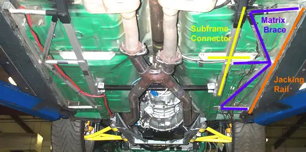

Let's see if I can explain this... there is a "lip" along the inside of the side skirts. It is a piece of metal that hangs down about 3/4" and has notches for the stock jack to bite into. I'm not sure what else is attached to it but it's your stock jacking points. If you use a standard hydraulic jack the lip will bend and curl. The jacking rails would be welded in just inside of the lips to provide a stout piece of metal that is stronger than the thin lip provided stock. It can handle a hydraulic jack and it won't bend and it can support more weight than the stock jacking points. Jacking rails would not be good for an OEM jack, you would be better using a hydraulic jack on them.
My subs and the rest of my kit. Jacking rails are the two rails at the bottom...
And the kit installed (on another car)...

ohhh.. i get it now. thanks alot i was wondering if they covered the plastic underbody piece all the way out to the side of the car, but i guess not. since my stock rails are all bent up, the side piece sticks out a 1/4 inch or so (under the door). Ill post some pics later today/ tonight, and youll see what im saying. either the prev owner jacked up on the middle of the rail and bent it or all my scraping bent it in.
