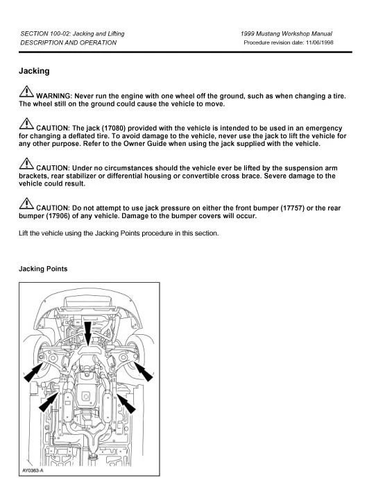

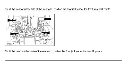

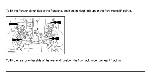

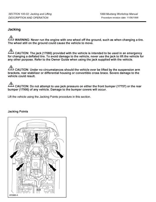

Here are the jacking points from the workshop manual (1999)- Curiously, there are no specific Cobra jacking points in the rear dealing with the IRS.
I have jacking rails along the sides, so I usually use the jack under the center cross brace to lift the front end. Jackstand both sides up front close to the pinch-weld emergency jack location. Then I use the floor jack under the IRS lower arms under the springs to lift the back end (similar to what is shown in the diagram for jacking the front). Then jackstands on each rear side near the rear factory emergency jack location.
I'm not sure if you can jack under the IRS frame assembly safely or not. The large tubular IRS frame may be OK, but I certainly wouldn't lift using the differential case.
I love "Warning" number one.
