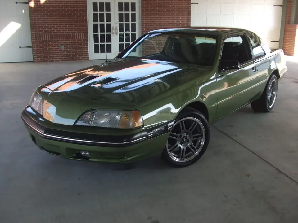

Your car is sexy. I might even ride in it... :P is the stock paint? I like that color, and nice wheels :)

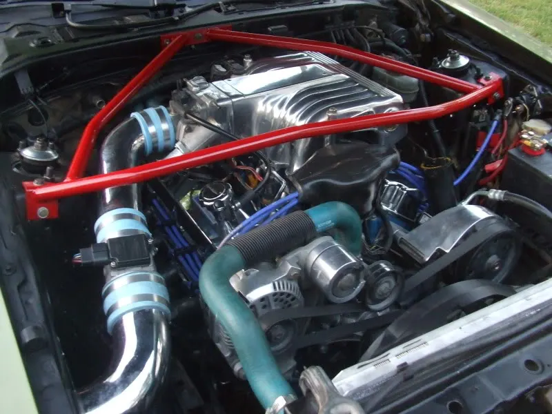

And your engine bay looks perfect in that pic.. I don't see what you mean by you need to clean it up..

I wouldn't get into loaning out engine hoists or anything else either.Good for you to saty away from that.The guy is probably on the level,but,no need to take chances.He can always rent one from somewhere.Thanks for the compliments. The Sport has nothing left from the factory.Nearly every single part has been replaced.The original color was Sandalwood (pale metallic gold) with tan leather interior. The current color is Dupont Effect Green. Very different,and way different from the rest of the Birds I ever see......which was my goal.I just have to be careful to not over-do it.Mustangs can take a lot of body mods and colors that a Thunderbird just CAN'T pull off even in the dark.LOL. .The engine bay is pretty messy right now.I am swapping to another Explorer intake and selling mine to a guy on another forum (I had a cool idea smack me in the brain last night for a unique "design" that nobody else will have) ,and I'll install my roller rockers at that time.The wheels I've seen on quite a few Mustangs,but a year ago I hadn't seen them much at all,and never on a car like mine.They fit the overall look I think.
