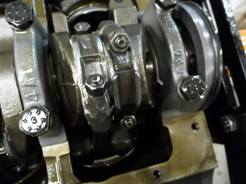

Yup, thats what it is tonight. Along with Motown and smallblocks. Damn photobucket wont upload my other pics or otherwise I'd show you.

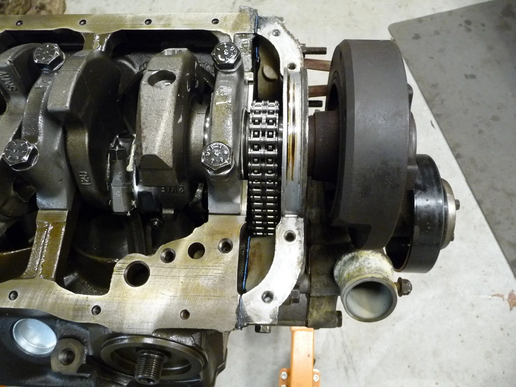

Putting the timing chain and gears together and slapping the cover on. After that, oil pump and pan.
Ok, could only handle the Motown for a little while so now it Eagles and Skynyrd

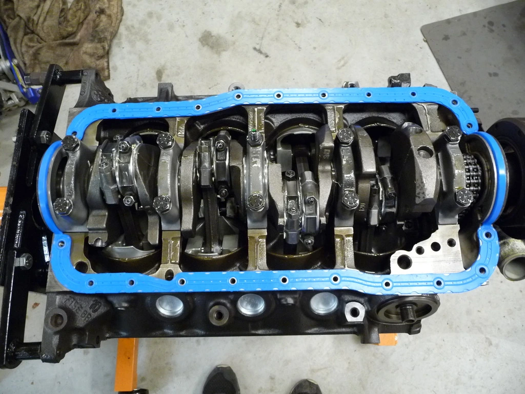

Block Front
Chain in and cover on
Nice one piece pan gasket
#7 was the lightest piston. #8 was the lightest rod > see it untrimmed compared to #7

Put a dab of black rtv on the corners of the rear pan gasket. right where it meets the caps. those gaskets leak there.
Looks good!

Oh, and don't forget your oil pump.

Dab of RTV at main cap corners. 10-4
