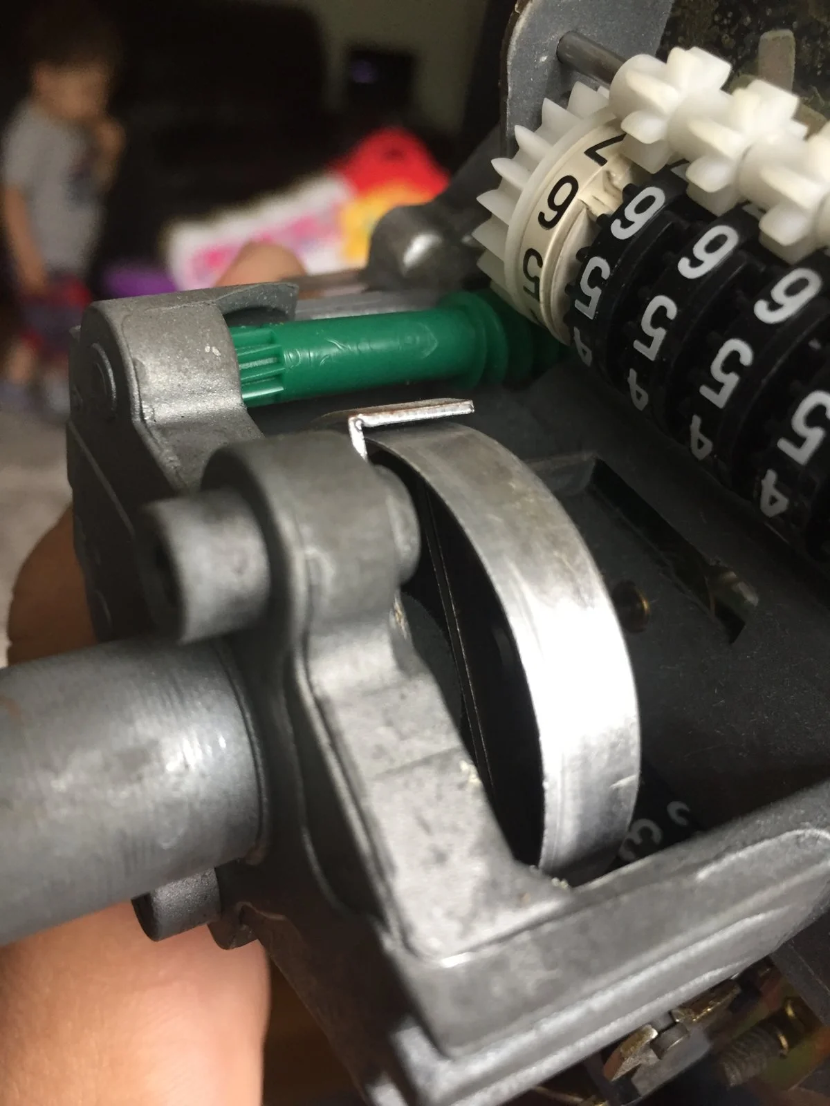

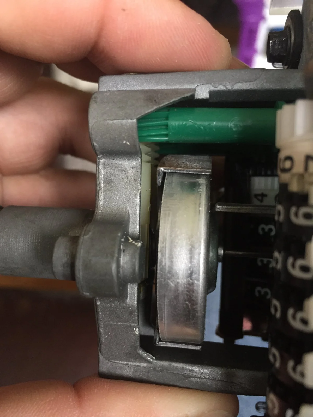

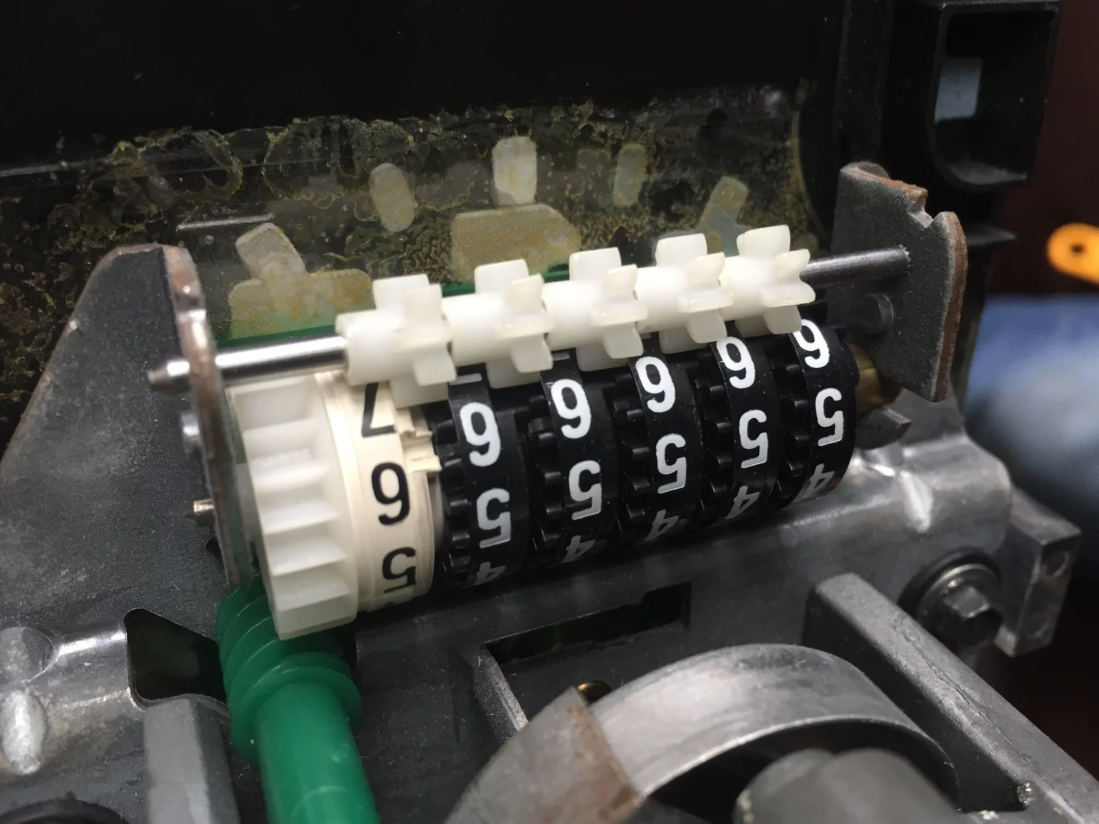

Ok went and grabbed my 85mph speedo.
Here's where I think the issue is. The speedo cable turns a cylinder that has two fingers that "grab" a cylinder connected to the speedo needle with spring resistance. Unsure if the gripping force is magnetism or friction, but the cylinder also turns two sets of gears that operate the odometer and tripometer. If there's any binding in those gears it will show as a bouncing speedo. Lubricstion may help.

Yes, he odometer is physically connected to the speedo cable and turns by gearing directky as seen in above pic. You could physically hold the needle down and the odometer will still work.
