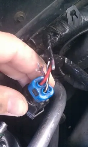

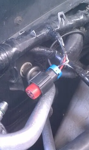

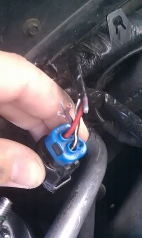

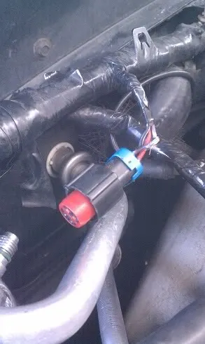

Here are some pics. The purple wire was cut by me during testing. I have since reconnected it. The plug looks stock..
Colors are Black/white, Red, Purple
Also, when I bought the car it the PO had directly wired the plug that supplys power to the compressor with two wires that ran under the passenger side dash to a thermocoupler of some sort that then fed into a connection under where the dash and door meet on the passenger side. I took it all out because it was Kentucky Hillbilly craftsmanship at it's best.
And to confirm, if I supply 12v to the blue/yellow wire on the high pressure switch (near the radiator) it kicks the compressor on. I jumped the purple and no wire pins on the low side cycle switch and nothing happend but again that purple wire has 5v but the red has 13v or so.

The round plug is the low pressure switch. The Red and BK/WH wires are not stock. Need to know where they come from.
The voltage on the purple wire is a problem. Go back to the AC/heater mode controller in the dash and measure there. IMO, you should "know" what you are dealing with before digging too deeply. It's obvious the mods were done for some reason. If you can't get +12 volts out of the mode controller, it won't do much good to restore all of the other mods.
The next problem is what has happened to the DB/Y wire from the low pressure switch. Suggest pulling back the tape and seeing where the "mods" were done. Again, if you can't get a good wire path on the DB/Y wire from the low pressure to the high pressure switch, it still won't work.

Okay, peeled back the tape and it appears the wires are definately stock. The connector also has the FORD logo on it so it appears stock as well. It has numbers for all 4 pins and pin 1 is the one with no wire going to it.

Well, I figured it out. The PO had the wrong plug connected to the switch. The correct switch with Blue/y and purple wires was connected to a vacuum line with a switch on it. I reconnected properly and will test in morning. I'm sure this will solf my problem. However, now I have a new problem. The vacuum line comes from the passenger fender and runs to a switch which then coninues the vacuum line but the line has been pulled off. On a V6 this line runs to the intake manifold. Unfortunately I don't have vacuum diagrams. (wmburns: thought that CD would have the vacuum diagrams or am I missing something?) Thanks.

Finally found what the connector is for.
EVAP purge flow sensor. It's on diagram 024-10. Connector C195. The wire colors are Red, P/W, and BK/W.
