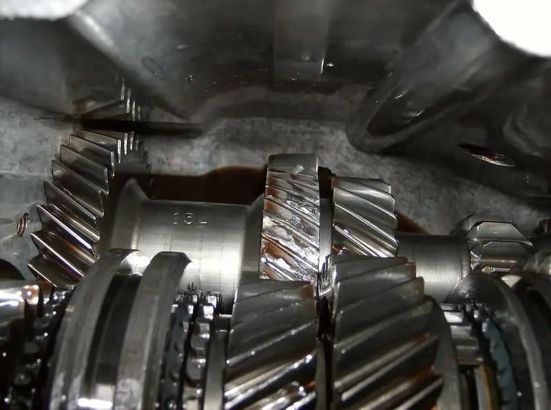

Just a couple t5 carnage pics.
blackened88lx
Aug 9, 2006
28
Connecticut

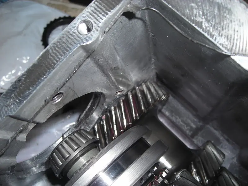

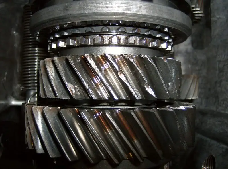

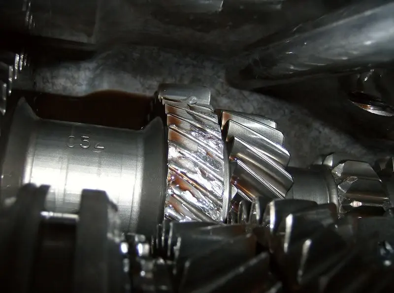

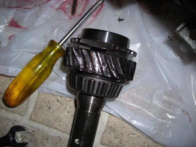

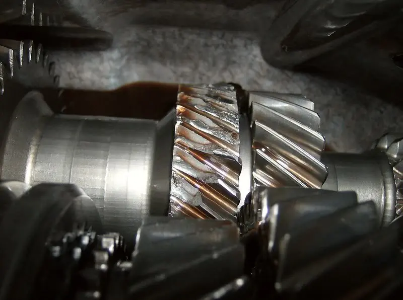

As some of you know, I broke the t5 in my car a couple weeks ago. I finally stopped being lazy and pulled it out and apart Sunday. Everything inside actually looks halfway decent except for 3rd gear. I didn't take it apart completely because I'm not sure what I'm doing with it yet, but I took a couple pics of 3rd gear. The countershaft gear is missing about 10 teeth, and the mainshaft gear is just a little chewed up.

Ah, the good ole 3rd gear failure.
The reason 3rd fails so much is because it's located in the middle of the trans away dfrom any structural support. When in 3rd, the gears will try to push themselves apart. The mainshaft flexes a bit and the gears spread to the thinned areas of the teeth. Since these are weaker, it's only a matter of time.
It's why a hardened mainshaft is a good upgrade for a t-5...but a TKO or T-56 is a better upgrade

43k miles, I'm the second owner, and the last guy drove it like grandma. I've owned the car for about 6 months, and have around 6k miles on it. You just can't powershift it a lot if you want it to live. I drive the car every day in the summer, and I powershift it a few times every time I drive it, so if you think about, that's more abuse than a track car would get.
