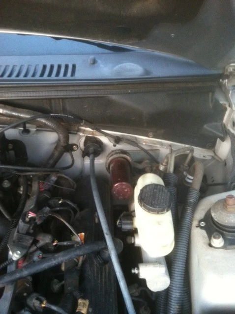

Ive never owned a 1999-2004 GT and not shure if you can adjust clutch cable by simply pulling up and back of clutch peddle and letting go. the clutch is right on floor and id prefer it to be somewhere close to middle. anyone? glad to be back on the right side. just sold my corvette and wrecked 2006 350z to buy this 40th anvir mustang GT with 89k miles with few bolt ons. god I missed ford. hate opti sparks they make baby jesus cry.
Ive searched a few post. some people say lift up on back of clutch peddle till it clicks. but all the posts either dont say what year the car is or its not my year model car. the clutch peddle is right as you start to release the peddle and cause me to grind gears. could someone with a 2004 model tell me how to correctly adjust the clutch? also is the clutch hydrolic? some clutches ive seen share the break fluid container. and mine was real low.had air in it.

They were cable operated clutches up to 2004. You should be able to pull up on the pedal to make the adjustment UNLESS someone replaced the quadrant with an aftermarket one. There is also a hydraulic conversion kit for these cars, but I've never seen one done.

My GT is an 04. It definitely has a cable clutch in stock form. To adjust the pedal pressure location is complicated to describe. Go under the dash put one hand above the pedal and work the pedal with the other hand. Feel around above the pedal until you feel an arm of sorts that pivots with the pedal. With the pedal to the floor grab that arm and pull the pedal upward until you hear the clicks. There are multiple clicks that adjust to different positions. Once you gain a picture of how it works, you may want to do the adjustment using your feet. Propping one foot behind the arm, under the dash, and lifting the pedal with the other foot. Its difficult to put into words but assuming the system has not been converted to hydraulic, it will work.
The car has almost 90,000 miles on it and depending on how the clutch was treated, the adjustable mechanism may be out of space to adjust itself. It may be getting time for a new clutch. Also, the cable could be stretched causing the adjustment space to be used up prematurely. Is the clutch pedal really hard ? If so it may be time for a new clutch.
I would consider replacing the clutch cable and stock quadrent with an aftermarket adjuster and quadrent as well as a new OEM cable as a first step. I like the UPR adjuster the best so far of all the ones I've see. Don't get the Maximum Motorports adjuster, I have it and I'm going to be replacing it with the UPR unit. The MM, UPR and Steeda quadrents are all decent. I will say that I have seen the UPR quadrents brake where the cable attaches.

If it's the stock clutch quadrant as well as stock cable, you could have a crack in the stock plastic clutch quadrant that is just waiting to let go and leave you clutchless. Do what was said about getting under there with your hands, then using your feet, but if it feels like the cable is already on the tightest click, that means you're about to crack the stock plastic piece and you should order a new and preferably metal quadrant from the aftermarket asap.
