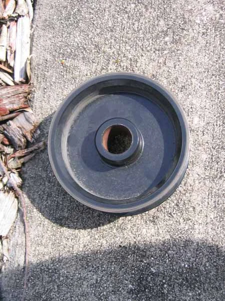

thanks for the help guys...im a few hundred miles in and absolutely love the car. had one more question...the car came with the stock airbox setup in the trunk as well as a random grooved pulley and belt. im attaching a pic of the pulley...its about 3-3/4" in diameter where the belt would sit, about 4" to the flanges, and im not sure which one it is...I looked and cant see anything blatantly aftermarket. i couldnt really see the factory s/c pulley under the cover sooo im not sure if maybe that was swapped out by the original owner??? the car pegs the boost gauge but ive never really driven another '03+ Cobra to tell where the needle should be under throttle. having bought the car wholesale you dont exactly get service records or anything so im still combing the car over.
also she pings pretty badly under full throttle...originally i thought it was the gas that had sat in there a month so i took it easy and burnt it all out but two fresh tanks of 93 later its still pinging under boost...doesnt sound normal?
thanks for the advice on the mods...im gonna go with bassani exhaust and a pro-5.0 for now. any help on the pulley/pinging situation would be greatly appreciated. thanks again.
The picture you posted along with the measurements provided leads me to believe the pulley in your trunk is the stock (3.65") one. With a belt in the trunk too I'm betting the previous owner has installed at least a 2.93 pulley or smaller. As for the boost gauge, on a stock Cobra it will come close to the "10" mark on a really cold day, if you are pegging it then you most definately have a smaller supercharger pulley installed. Since the stock airbox is in the trunk it sounds like you have a CAI installed too. You might want to crawl underneath and see if it has an aftermarket cat-back...
Now listen to my advice here about the pinging.....
GO GET THIS CAR TUNED ON A DYNO ASAP! Nothing will destroy your supercharged motor faster than detonation (pinging)!!!!!! Do NOT get on it anymore, PERIOD! NONE! NO MORE WOT. You need to stay out of it COMPLETELY!
You also need to pull the passenger side kick panel and inspect the EEC. Check the port on the side of the computer and see if there is an aftermarket chip plugged in. If there is get the name off of the chip because you're going to need a re-burn!
You've got yourself a nice Cobra there STEEDA85GT, don't melt the motor now by running a bad tune! If you can hear the engine pinging over the whine of the supercharger, you've got a MAJOR problem and need to rectify it ASAP! I just hope that damage hasn't already been done.... it's very possible the previous owner added a 2.93 or smaller pulley and a CAI, but never got the combo tuned. Now the engine is possibly damaged and that's why the previous owner dumped the car. Get it checked out NOW, you could be looking at some very expensive repairs!

Very true.. Could you take a pic of the engine for us.. It could help out a lot. Try to take off the pulley cover.. that would be even better! It's just three bolts.. pretty simple..

Car definitely has a 2.80 pulley and had an old Diablo pulley chip in the ECU. Pulled the old chip and ran the Predator tune...a world of difference. I'm going get exhaust on the car (within the next couple weeks) before putting it on the dyno. Everything appears to be ok though...have a feeling I dodged a bullet on this one.
