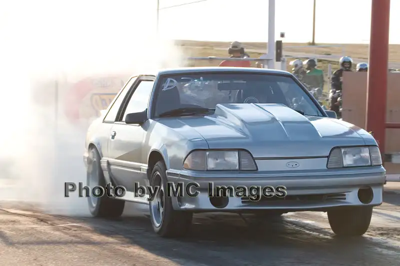

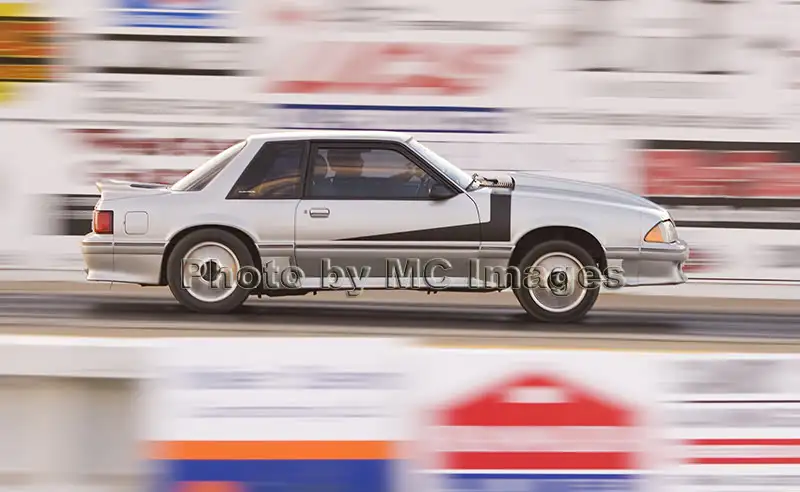

Hey guys I just bought myself a new track toy. It's an 88 notch with a bunch of goodies done to it including a 150 shot of nitrous. It still only has a 302 bored out to a 306. I want to find a more stout motor for this thing. My goal is a 351 stroked out to a 408 with a Vortech V7 YSi trim blower on it. I know I can get the blower just need to find a place where I can pick up a 351 and a stroker kit for it that won't cost 20g's. i just gotta figure out if the V7 will work with a 351 or just a 302 style.
Here's the car anyways, I'm picking it up on Monday.

:hail2: nice very nice
thanks man. I'm gonna need some of you experienced Fox guys here in the near future I'm sure. I don't know much about these cars so this is gonna be a steep learning curve. It should be all nuts and bolts like my other car, just a totally different aftermarket and so many damn chioces with these cars, especially motor wise. I talked to a friend last night and he has a newly rebuilt 351 Cleveland on a stand in his garage, just needs an intake. He said if he can find a 429 he'd sell me the Cleveland. Once again I don't know the advantages or disadvantages to the Cleveland motor. I know they are stout but what aftermarket is there for them or is this gonna be a swap meet type of easter egg hunt for parts for this motor.
