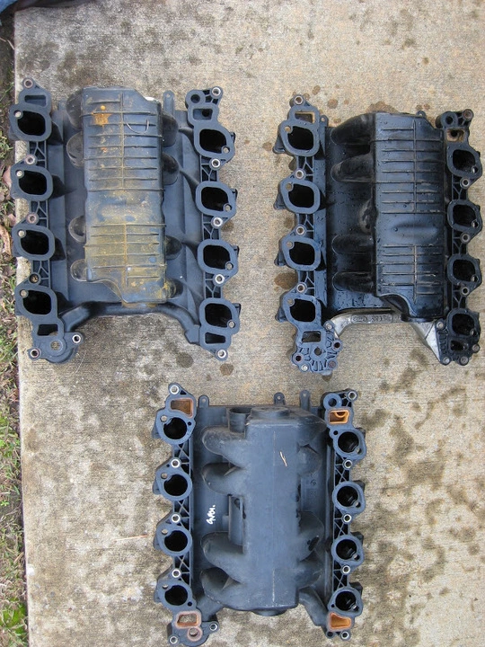

What are the shape of the intake ports (teardrop or square)? The PI intake is square where as the Non-PI is a round tear drop shape.

Here's the intake port shapes that Wmburns is describing - the two intakes on top fit PI cars (like yours) and the bottom one is an earlier NPI intake.
