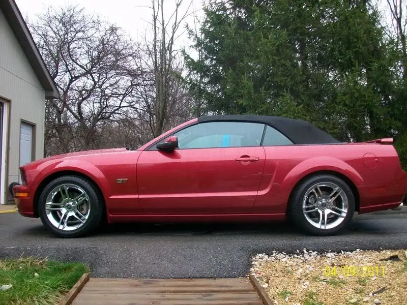

here's the pict. In looking at it may just leave alone and not do front. driveway has a downward slope. I'll have to check it out more on an even surface.
Yeah thats an improvement over the stock raked look for sure. Level.
