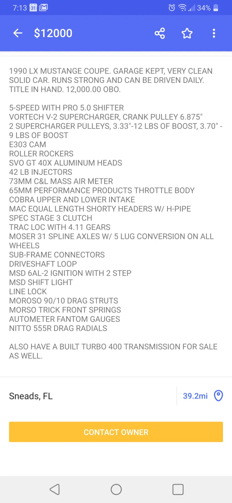

I just got a new to me mustang. I want this car to be more a weekend cruiser than a total drag car. It idles around 1k rpm. How do I go about tuning it? A shop?
Is the cam and head setup mild enough to be street driven?

I will attach a mod list below.

I think that’s a fine engine set up for the street. The throttle body may be a little undersized and some people have issues with c&l maf’s. As long as it runs fine, no need change it. You can use a local tuner, if there is one near you able to tune eec iv. It’s kinda a dying art though. You may need to get a stand-alone like mega/micro squirt, pimp, terminator x, and tune it yourself.
It's setup for drag racing with the line lok and drag struts. May have to change some suspension for more streetable ride.

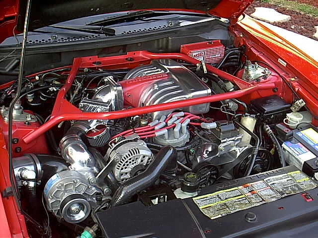

Other than that, I basically ran a similar setup. My 94 had a V-1 Vortech, the same GT40X Heads (with upgraded valve springs and valves), Crower Baby Cam, Long Tubes, 2.5" Exhaust all the way back, Edelbrock RPM Intake, 70MM Throttle Body, Pro-M 80MM MAF, same 42 pound injectors. Car made a tad over 480HP at the wheels but it was with an aggressive pulley on the blower (15 pounds). Second day after the tune I was racing a chick in a supercharged grabber blue Mach 1 back in the day....saw 18psi and then white smoke out the back. Blew the driver head off the block. Changed the head gaskets, pulley'd back up to a 3.33" pulley for 8-10 pounds. My car usually made more boost with the tension I was using at the time.
You should be making over 400HP at the wheels. That would be a nice street setup considering the new Mustangs make 450+ these days stock.
