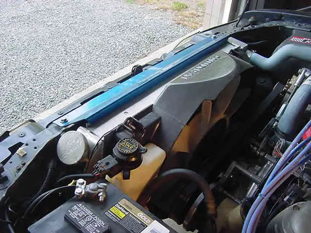

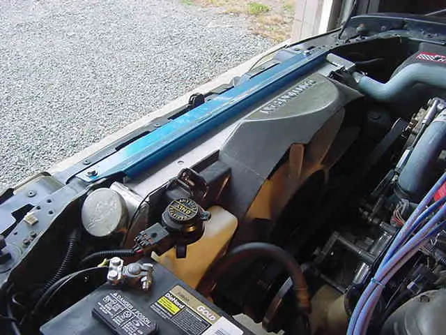

About the fan shroud -- I'm not sure about it being the right or wrong size. It is freaking huge in my mind because I couldn't even fit the overflow bottle on the car like its supposed to go. I was wondering if the previous owner threw on a bigger fan and shroud when he put the new radiator on. I've got pics.
I have better pics after I rigged the overflow bottle in...temporary fix. I just need to save it on the computer...later.
I don't think that's the right shroud. It should look like this...
