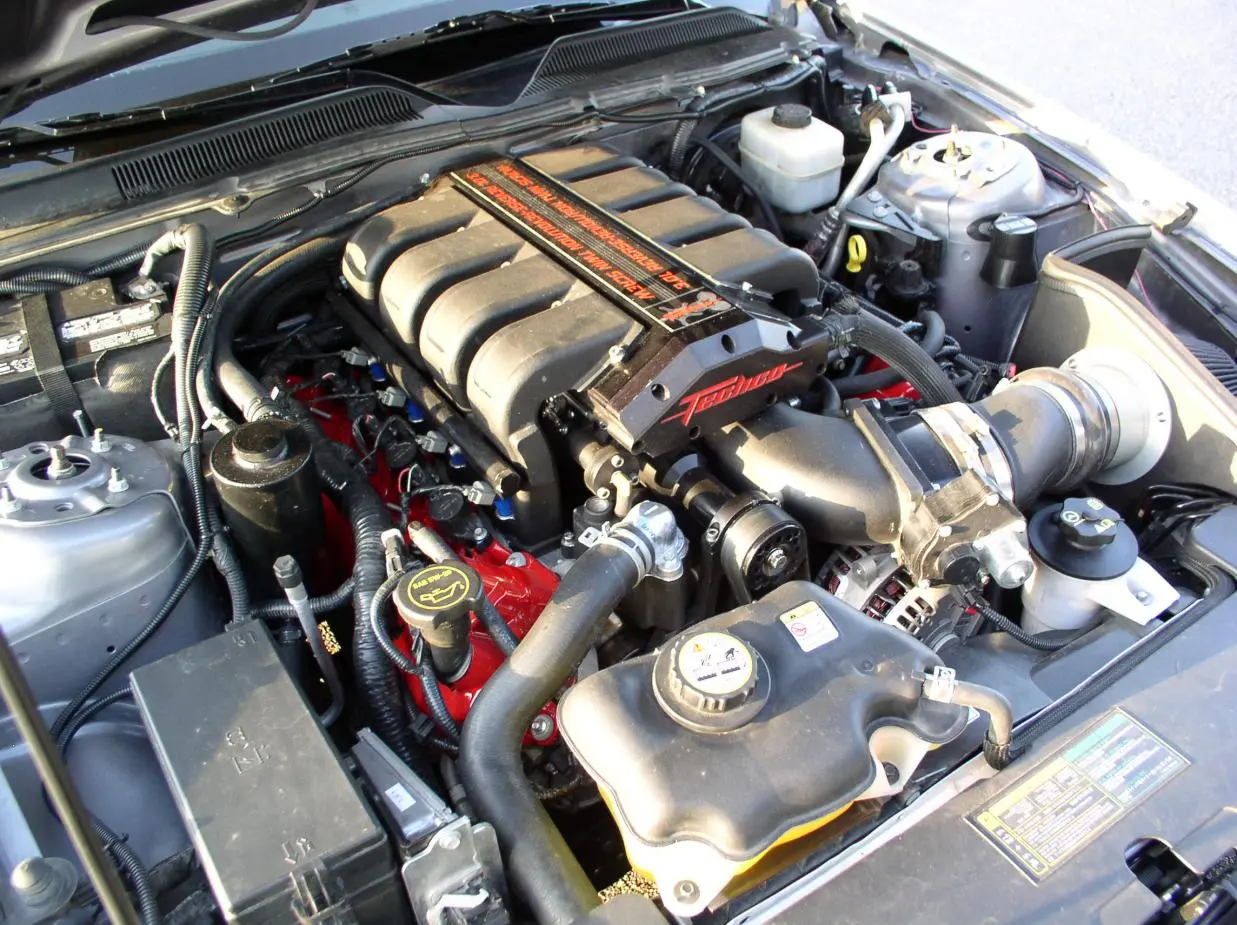

I just finished installing the techco supercharger and it is awesome!! I have a little problem with my check engine light comming on though. We tuned it with a sct tuner and used the kenny bell setting since their isnt a techco one. We also checked the codes and it comes back to the sensor that goes hooked up to the upper intake manifold on the back end. I was wondering if anyone has encountered this before or if anyone has solved this issue? I will post pics soon of the car. Any suggestions are appreciated. By the way the sensor or connection Im taking about was left unhooked since their isnt a connection to hook up to it on the techco.

Leaving the sensor unhooked sounds a whole lot like your problem. Still you're also running the tune for a different supercharger. I know they are similar in theory but who is to say that a tune for the Techo wouldn't shut off the sensor and prevent your CEL issue? Also why use the KB over a Saleen tune? I know the KB is a bigger unit and the Techo is a pretty big supercharger but aren't they very similar in construction to the Saleens? Finally could there be some plug to cap off the sensor like a an O2 eliminator that you may need to get a hold of?
Just some ideas I could think of.
Good luck and let us know how it turns out!
