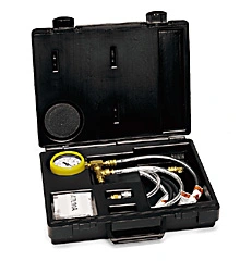

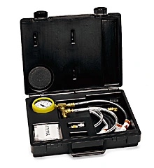

the adapter will come with the fuel pressure guage. just buy the whole kit. they sell them at every pep boys and autozone in the entire country. you're making a 3 minute operation seem like its a big deal. :rolleyes:
Who wants to ride around with that kit in their car when all he has to do is get an adapter for $5. He already has a gauge to go under the hood that will stay installed. :nonono:

i bought one of those fuel pressure kits and i dont keep it in the car. i only use it twice a year so it stays in a closet in my apt. who says he has to keep it in the car. he'll use it once to set the pressure and thats it. do you keep all of your tools, floor jacks, jack stands and ramps in the trunk?? no!! why should you keep your fuel pressure gauge and schrader attachements in the car?! the fuel pressure kit will stay in his garage with all of his other tools.
where did he say that he has a gauge that will be mounted under the hood? i thought that he had to save up for the autometer unit but wanted to buy a gauge to check the fp after the fpr installation.
